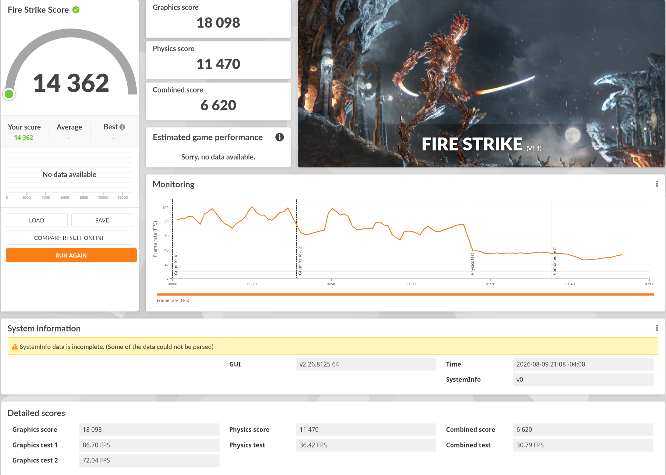

Khenglish Posted August 10 Posted August 10 Raising the TDP does work though. This is 125w vs 110w in firestrike: systeminfo doesn't work, but this is on a P150EM with a 3920xm at 4.3ghz that is modded for direct dGPU display output.

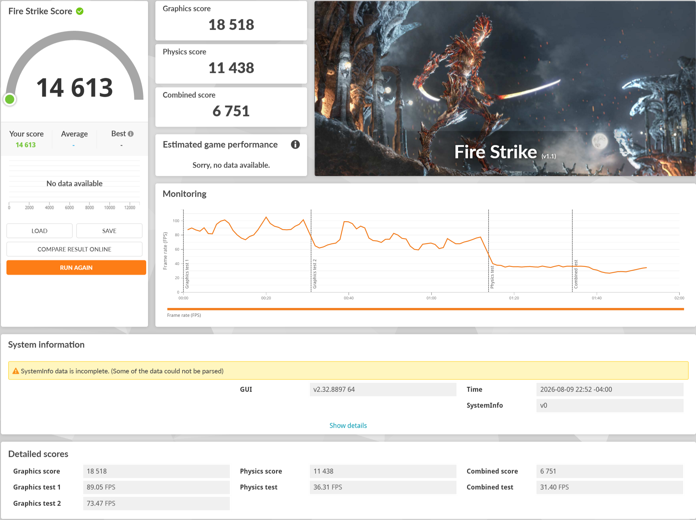

Khenglish Posted August 10 Posted August 10 Time Spy with 150W power limit (effectively no limit). Also, the power slider does work. Only Nvidia Inspector (NOT Nvidia Profile Inspector, you need Nvidia Inspector from ~2017) can control it, but it works.
