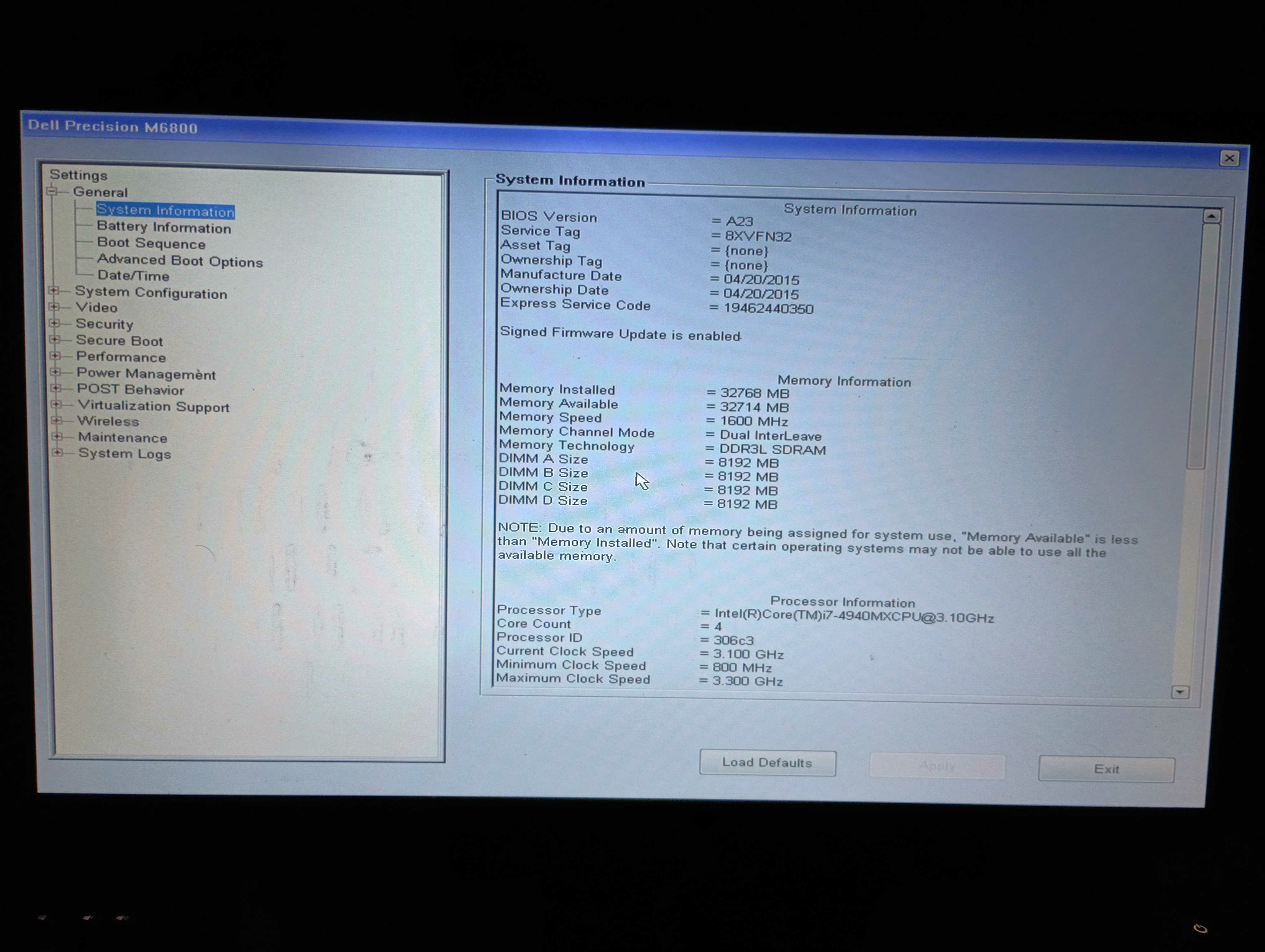

AaronD Posted August 30 Share Posted August 30 On 8/8/2025 at 2:53 AM, DynamiteZerg said: I still have the P5000 working in my M6800 I tried another P5000, Version 86.04.3A.00.25: With Switchable Graphics turned off, this one appears as "Unknown video card", whereas the previous attempt didn't even get that far: Regardless of the Switchable Graphics setting, Ubuntu stalls as soon as it gets control: The first try had a black screen with no drive activity and no response from anything, so I pushed the power button. Still nothing, so I held it until it powered off. All subsequent tries had a GRUB menu, I guess because it didn't have a clean shutdown and so the other menu entries might be useful, like memory checks and so on, or even a different OS if it were configured for one, which this one is not. GRUB works normally, but Ubuntu still stalls with the same behavior, except it has the partially dismantled remains of the GRUB menu instead of all black. Never got an Ubuntu splash screen, until I swapped back to the old K5100M. Then everything works as it did. I only got one system log from all that, which I've also attached here as debug.log. (normally, there's one for each boot) Not entirely sure what I'm looking for in there, or if it says anything useful anyway. Is there something I'm still missing? Not asking @DynamiteZerg to take a working machine apart to get *that* picture, but could you possibly post a BIOS shot of how a working one appears there? debug.log Link to comment Share on other sites More sharing options...
AaronD Posted August 30 Share Posted August 30 BIOS Version A23: I also have a Firmware Updater app that came with this flavor of Ubuntu, that seems to say that there isn't an automatic one available: And of course, there's still the BIOS's own update utility that I would guess requires a USB flash drive with a file on it. Link to comment Share on other sites More sharing options...

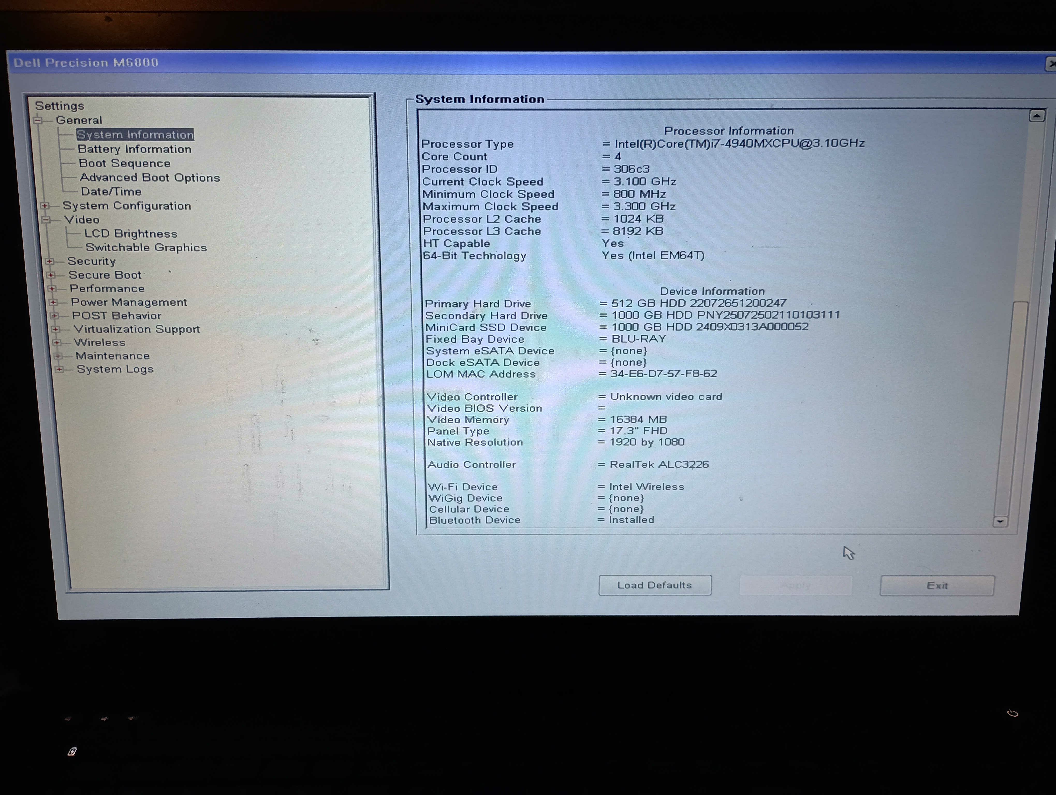

DynamiteZerg Posted August 30 Share Posted August 30 4 hours ago, AaronD said: I tried another P5000, Version 86.04.3A.00.25: With Switchable Graphics turned off, this one appears as "Unknown video card", whereas the previous attempt didn't even get that far: Regardless of the Switchable Graphics setting, Ubuntu stalls as soon as it gets control: The first try had a black screen with no drive activity and no response from anything, so I pushed the power button. Still nothing, so I held it until it powered off. All subsequent tries had a GRUB menu, I guess because it didn't have a clean shutdown and so the other menu entries might be useful, like memory checks and so on, or even a different OS if it were configured for one, which this one is not. GRUB works normally, but Ubuntu still stalls with the same behavior, except it has the partially dismantled remains of the GRUB menu instead of all black. Never got an Ubuntu splash screen, until I swapped back to the old K5100M. Then everything works as it did. I only got one system log from all that, which I've also attached here as debug.log. (normally, there's one for each boot) Not entirely sure what I'm looking for in there, or if it says anything useful anyway. Is there something I'm still missing? Not asking @DynamiteZerg to take a working machine apart to get *that* picture, but could you possibly post a BIOS shot of how a working one appears there? debug.log 1004.23 kB · 0 downloads Gimmie a minute to boot up the M6800 to get to the BIOS shot for you. Link to comment Share on other sites More sharing options...
DynamiteZerg Posted August 30 Share Posted August 30 I have switchable graphics enabled though. You want me to try and turn switchable graphics off? Link to comment Share on other sites More sharing options...
Aaron44126 Posted August 30 Share Posted August 30 “Unknown video card” is exactly what it should say. You might only get this with switchable graphics off. I’m going to suggest that you pull an old version of Ubuntu or Linux Mint, whatever was current when @DynamiteZerg did his vBIOS flash, and try using that to flash on the ES vBIOS. I vaguely remember having an issue when I tried a newer one. Do it with switchable graphics on. 1 Apple MacBook Pro 16-inch, 2023 (personal) • Dell Precision 7560 (work) • Full specs in spoiler block below Info posts (Windows) — Turbo boost toggle • The problem with Windows 11 • About Windows 10/11 LTSC Spoiler Apple MacBook Pro 16-inch, 2023 (personal) M2 Max 4 efficiency cores 8 performance cores 38-core Apple GPU 96GB LPDDR5-6400 8TB SSD macOS 15 "Sequoia" 16.2" 3456×2234 120 Hz mini-LED ProMotion display Wi-Fi 6E + Bluetooth 5.3 99.6Wh battery 1080p webcam Fingerprint reader Also — iPhone 12 Pro 512GB, Apple Watch Series 8 Dell Precision 7560 (work) Intel Xeon W-11955M ("Tiger Lake") 8×2.6 GHz base, 5.0 GHz turbo, hyperthreading ("Willow Cove") 64GB DDR4-3200 ECC NVIDIA RTX A2000 4GB Storage: 512GB system drive (Micron 2300) 4TB additional storage (Sabrent Rocket Q4) Windows 11 Enterprise LTSC 2024 15.6" 3940×2160 IPS display Intel Wi-Fi AX210 (Wi-Fi 6E + Bluetooth 5.3) 95Wh battery 720p IR webcam Fingerprint reader Previous Dell Precision 7770, 7530, 7510, M4800, M6700 Dell Latitude E6520 Dell Inspiron 1720, 5150 Dell Latitude CPi Link to comment Share on other sites More sharing options...
AaronD Posted August 30 Share Posted August 30 8 hours ago, DynamiteZerg said: I have switchable graphics enabled though. You want me to try and turn switchable graphics off? If it's not too much trouble. Thanks! Just want to see if a known working configuration reports itself the same as mine. 6 hours ago, Aaron44126 said: “Unknown video card” is exactly what it should say. You might only get this with switchable graphics off. I’m going to suggest that you pull an old version of Ubuntu or Linux Mint, whatever was current when @DynamiteZerg did his vBIOS flash, and try using that to flash on the ES vBIOS. I vaguely remember having an issue when I tried a newer one. Do it with switchable graphics on. I'll have to wait until after the weekend to do that, but it does sound promising... I also found an A26 version of the BIOS on Dell's website, compared to my A23, and downloaded it. Haven't installed yet. Any risk to that? Or possible benefit? https://www.dell.com/support/home/en-us/drivers/driversdetails?driverid=nr58c Link to comment Share on other sites More sharing options...

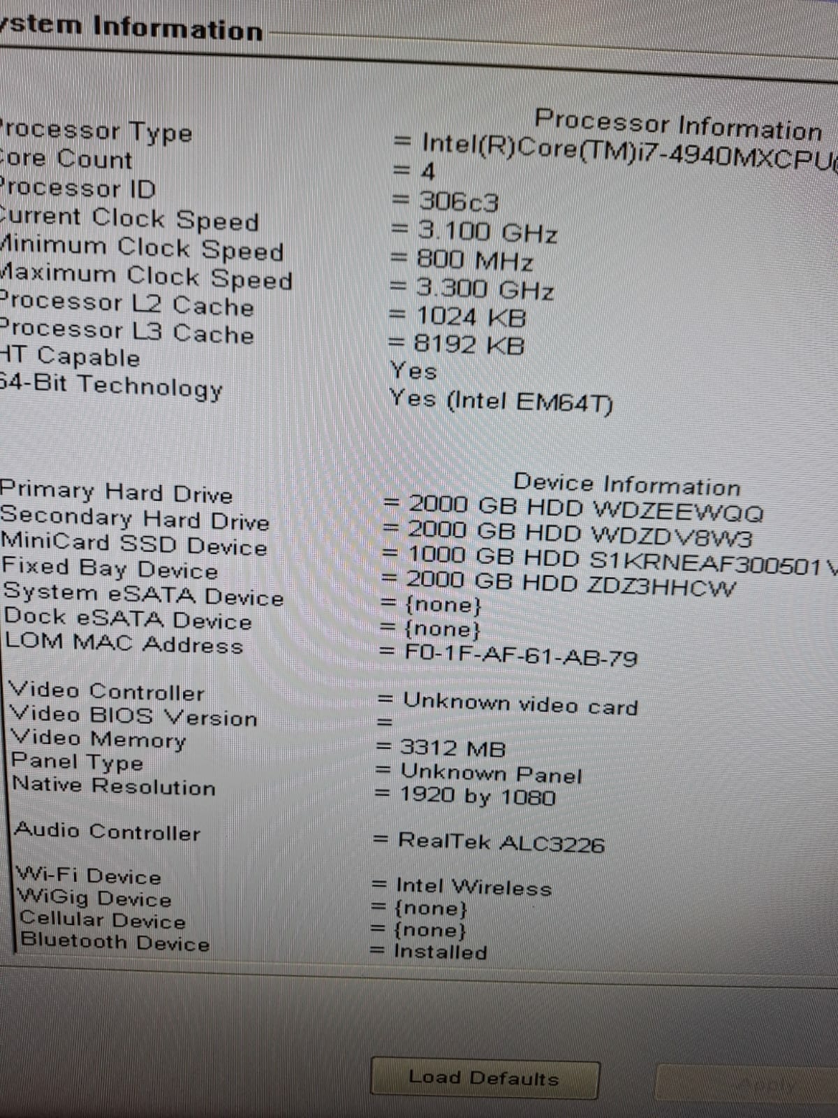

DynamiteZerg Posted September 2 Share Posted September 2 Here are the pictures as promised @AaronD It shows as "Unknown video card" with a weird amount of vram. By disabling the switchable graphics, it also switched to showing the bootup sequence on my external monitors. I remember seeing my old instructions for flashing using Linux Mint archived from NBR. The link is in one of the posts here. Let me dig around... and there we go! https://www.nbrchive.net/forum.notebookreview.com/threads/graphics-card-upgrade-for-m6800.806352/page-17#post-10748094 Link to comment Share on other sites More sharing options...
