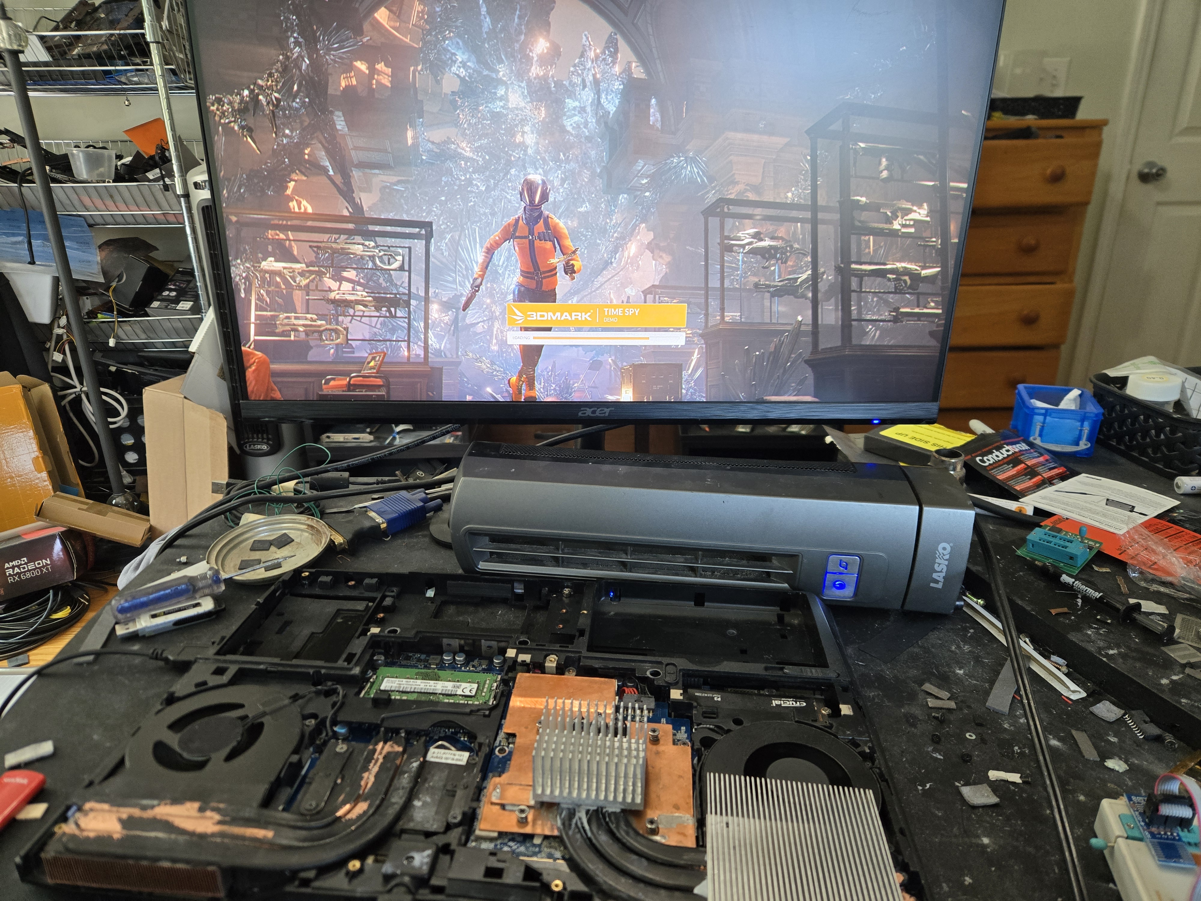

I take it that this is a P870 chassis with vapor chamber, how are temps during your TimeSpy runs?
1 hour ago, 1610ftw said:
This is still really impressive and very cool, good to see you at it again!

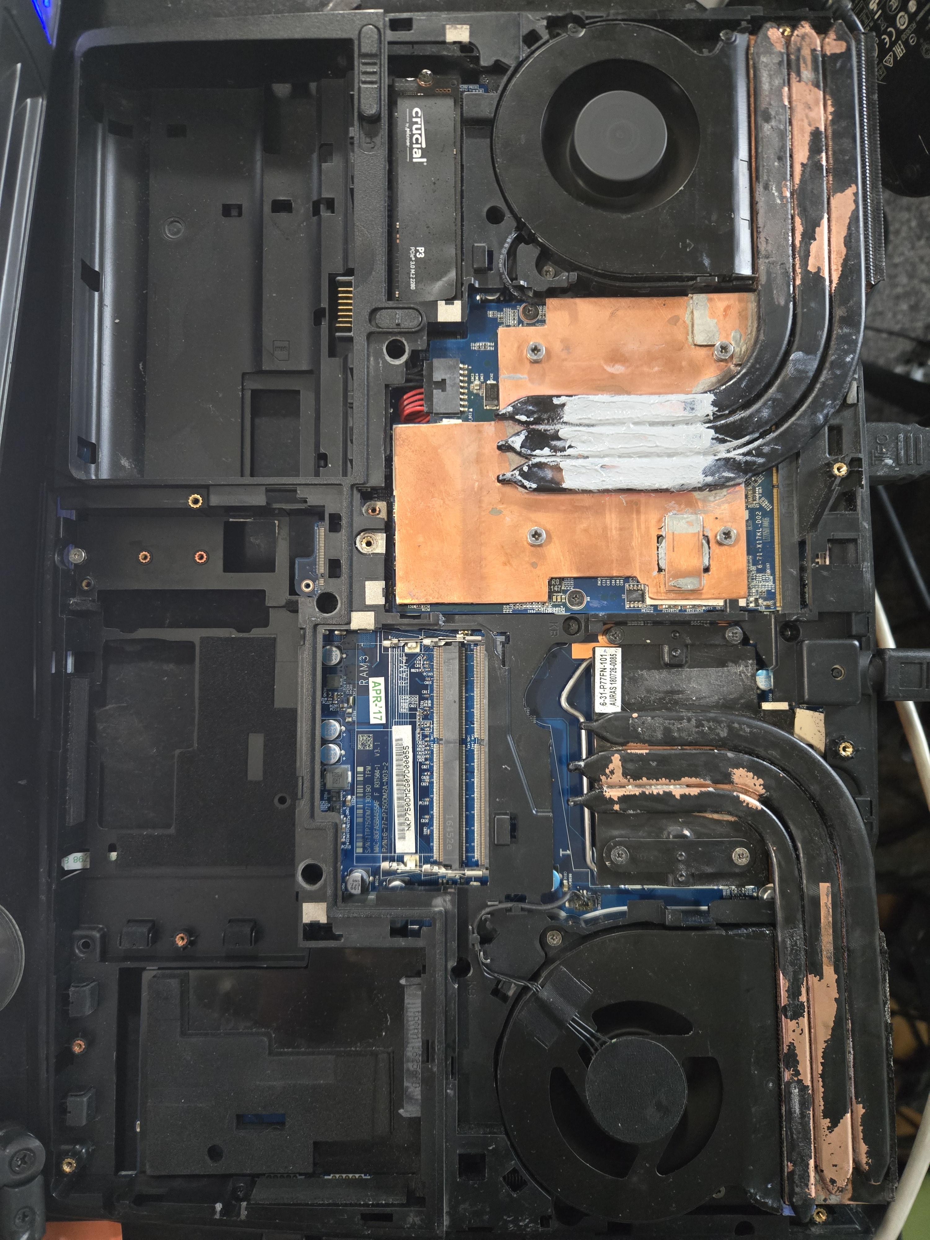

The end of the 2nd GPU test would be 59C. No vapor chamber. P750 chasis with P775 heatsinks as the baseline.
  • Like 5
Without the added heatsinks and external fan temps would cap out around 77C with the power limit mod after letting temps plateau. 67C at the default 155W limit.
P775 radiators are less deep than the fan depth. curving the fan shrouds into rhe radiator helps temps a little.
