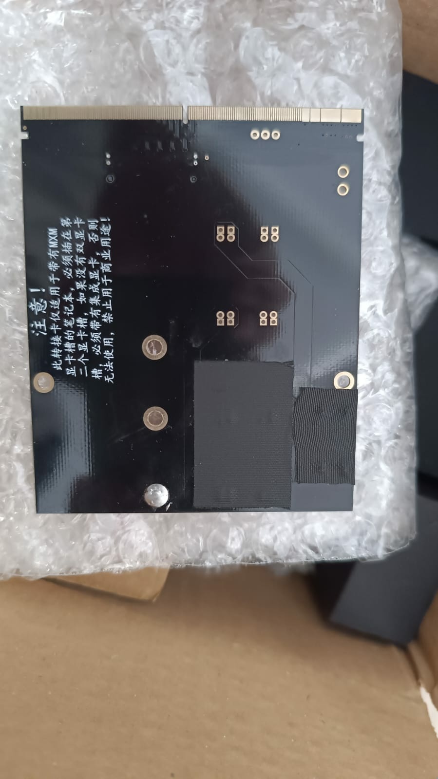

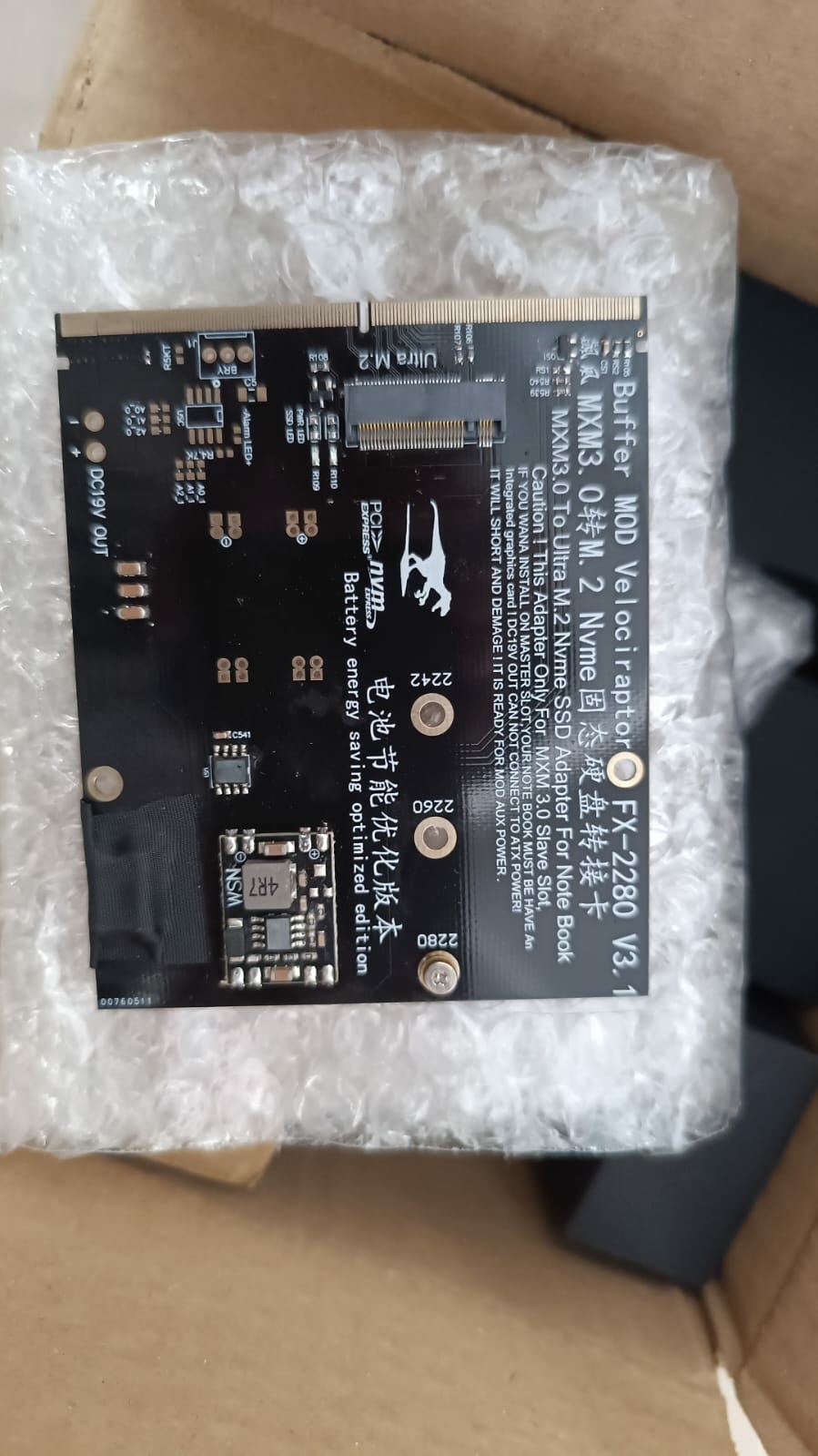

cisik88 Posted January 6, 2025 Posted January 6, 2025 Hello, i have a problem to make nvme drive visible anywhere. I bought cheap Ali adapter mxm nvme shown above. It doesn't matter if i install it in 1st or 2nd mxm slot, ssd is not visible in Windows/windows installer manager/bios. I tried various settings, uefi or legacy bios, SG or igfx, tried removing half of my ram, disconnecting msata drive, disconnecting bd drive. Nothing works, i could not get this drive to be recognized even a single time. When i took this nvme and installed it back to my second laptop, it's not recognized in Windows, i needed to use windows install manager to format it, it was shown as ubuntu drive....?
cisik88 Posted January 6, 2025 Posted January 6, 2025 ok i swapped nvme to second one with working Windows 10 and laptop booted normally. Drive is still not visible in bios but i assume that's correct. So basically You need to prepare drive on second laptop and then install it...

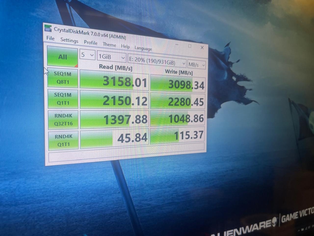

AXA Posted January 18, 2025 Author Posted January 18, 2025 On 1/6/2025 at 11:28 AM, mtvgt said: ok i swapped nvme to second one with working Windows 10 and laptop booted normally. Drive is still not visible in bios but i assume that's correct. So basically You need to prepare drive on second laptop and then install it... from what i remember mine worked fine it just didnt show up in bios since it wasnt officially supported. i cloned my OS onto the NVMe and it booted just fine. Mines a V2 adapter for reference Alienware M18X R2 | Nebula Red | i7 3740QM [OC'd to 4Ghz] | 32GB RAM | NVIDIA Quadro P4000 | 75hz OC'd Display | MXM to NVMe Adapter with Samsung 970 Evo Plus 2TB Alienware 17 R4 | i7 6700HQ | 16GB RAM | GTX 1070 | 100hz OC'd LG 1080p Display Alienware M18X R1 | Space Black | i7 2960XM | 16GB RAM | GTX 780M
cisik88 Posted January 22, 2025 Posted January 22, 2025 Yeah i think it's standard that nvme ssd is not visible in bios, but it works fine. What i also experienced and maybe it will be helpfull for someone in the future - MXM adapter didn't have a proper contact in mxm slot after tightening screws to max, i needed to use small washers between adapter pcb and screw holes. No idea why, never had this issue with GPUs, maybe adapter pcb is a bit thinner.
