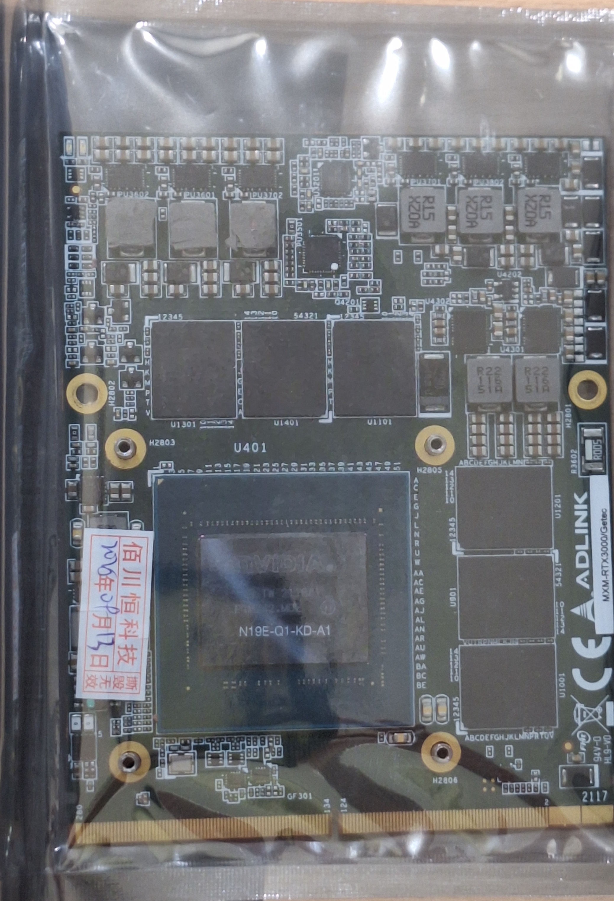

On 12/7/2025 at 8:21 AM, rjam said:
Did anyone upgraded to an RTX flavour on the M6800?
And what are the ways besides Ebay, sourcing MXM RTX's?
Thanks.
Someone was able to upgrade to the RTX 3000 before
Not sure where to get these RTX gpus outside of ebay, maybe a recycler? These were in some models of HP Zbooks IIRC. 17 G6 was the last with the mxm slot IIRC
Edit: Forgot to mention that there are some smaller companies that make these gpus, an ADLINK RTX 3000 was shown in this thread a bit up, as an example
Not sure where to get these RTX gpus outside of ebay, maybe a recycler? These were in some models of HP Zbooks IIRC. 17 G5 was the last with the mxm slot IIRC
I got two with the second being a doa on the cheap and I got them on eBay however I've been out of the loop for over a year when it comes to second hand mxm cards until the last couple days so yes there is a lot less available than there was a year ago. There is a source for these cards however one has to scrap a good laptop in the process which isn't economical.

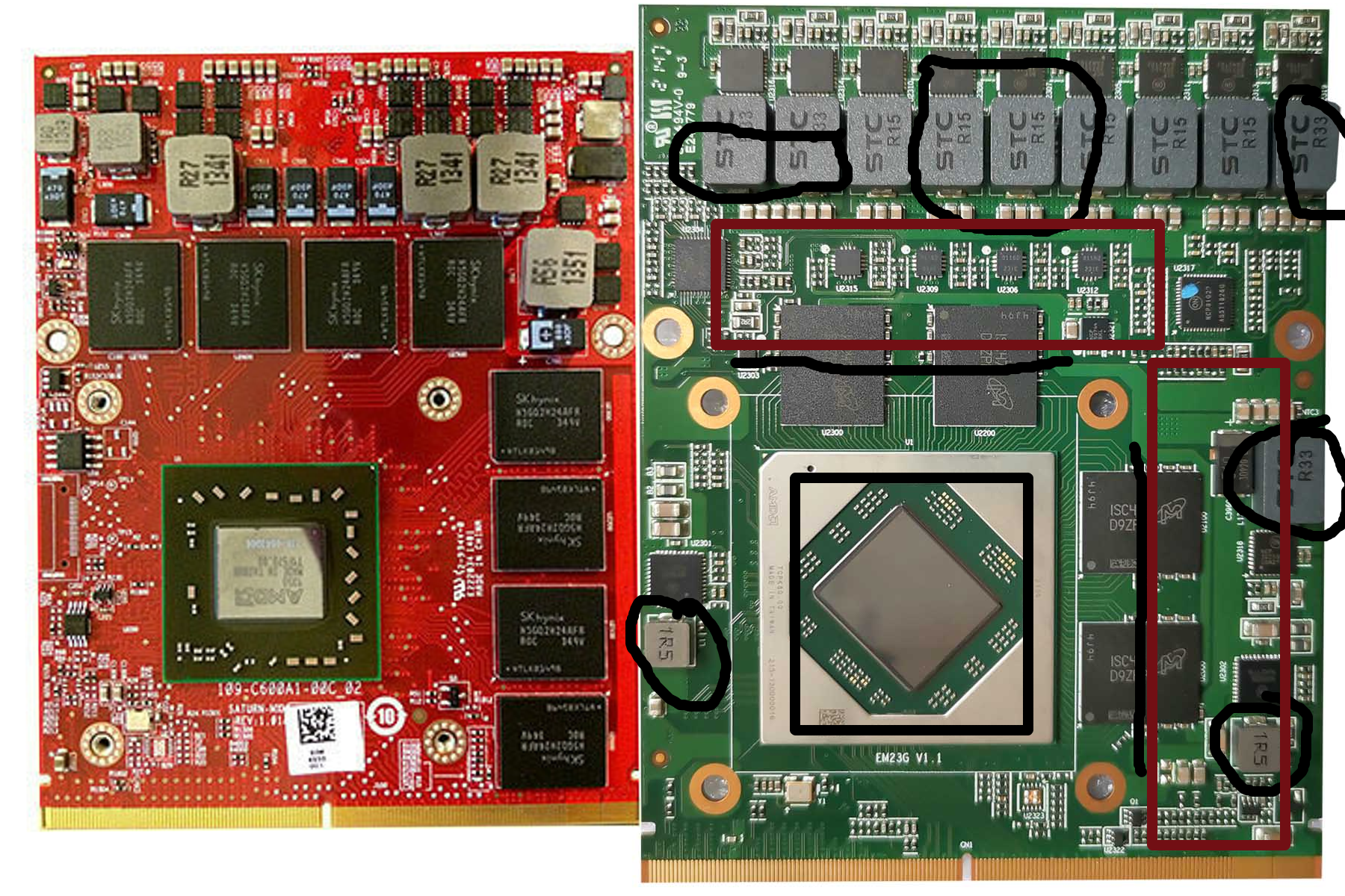

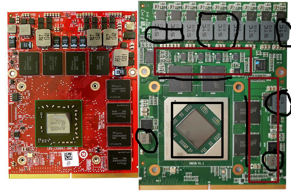

Has anybody tried putting in a AMD Radeon RX 6600 MXM GPU (Specifically the X-Vision one https://www.x-vsion.com/product/mxm-radeon-rx-6600-8gb/). The only problems I could see would be its 130W TDP and different VRAM placement  (FirePro M6100 Left,  RX 6600 Right)
image.thumb.png.bb3e34f9ecd104856f370ce21ed345a8.pngIf worst comes to worst I could do some major heatsink mods and cap the power limit to deal with those problems.  I currently have a LVDS panel and plan to upgrade to a eDP panel, but for now AMD Power Express should suffice.  How likely is this card to work, as it would be quite an upgrade over a GTX 1070.
