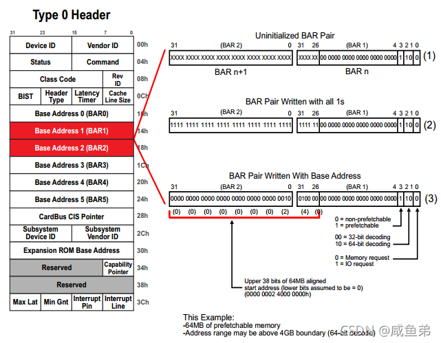

gluon Posted May 2, 2025 Posted May 2, 2025 Sounds good. Will follow with interest. A downtuned Ada card would be a big leap forward, given that the G2 would indeed support A4G. GPU-Z says that's possible. Testing is needed to be certain. As for ReBAR, found this article on how BAR works with MMIO. It focuses on PCI-systems, but the early phases are the same with PCIe. Quote BARs are part of the so-called PCI configuration register. Every PCI device must implement the PCI configuration register dictated by the PCI specification. Otherwise, the device will not be regarded as a valid PCI device. The PCI configuration register controls the behavior of the PCI device at all times... The size of the memory range required by a PCI device is calculated from the number of writeable bits in the base address bits part of the BAR... The lowest 4-bits are hardcoded values meant as control bits... The lowest bit is hardcoded to zero in BAR that map to CPU memory space... Bits 1 and bit 2 determine whether the BAR is a 32-bit BAR or 64-bit BAR... The 64-bit memory space is supported through "dual cycle" addressing, i.e., access to the 64-bit address requires two cycles instead of one because the PCI bus is natively 32-bit bus in its implementation... Bit 3 controls the prefetching in BAR that maps to CPU memory space. Prefetching in this context means that the CPU fetches the contents of memory addressed by the BAR before a request to that specific memory address is made... to improve the overall PCI device memory read speed... After the "BAR sizing," [the platform] can now map the video card memory into the CPU memory space by writing the intended address into the video card BAR. ReBAR, on the other hand, provides the CPU with a larger VRAM aperture. Quote PCI Resizable BAR is a novelty feature introduced by the PCI-SIG way back in 2007 alongside PCIe Gen 2, as sizes of graphics card dedicated memory were crossing the 1 GB-mark. The feature allowed the CPU to see all of the GPU's memory as a single addressable block, rather than through 256 MB apertures. Neither NVIDIA nor AMD bothered implementing it back then, and built several subsequent generations of PCIe GPUs using fixed BAR sizes of 256 MB, until AMD implemented resizable BAR for the PCIe root-complex of its "Zen 2" processors, and RDNA 2 graphics architecture, rebranding it as "Smart Access Memory." It produced tangible single-digit percentage performance gains in games, and soon the feature caught up with NVIDIA drivers and cards. Intel's PCIe roots support resizable-BAR all the way back since 6th Gen "Skylake," and the feature has been added through BIOS updates to most 300-series chipset motherboards (and newer). vBIOS delivers the PCIe config BAR to UEFI. This (dual) BAR is then mapped into CPU memory. ReBAR requires user config, so it has to be mapped into a new (third) BAR. Any supported PCIe device can also boot without it.
