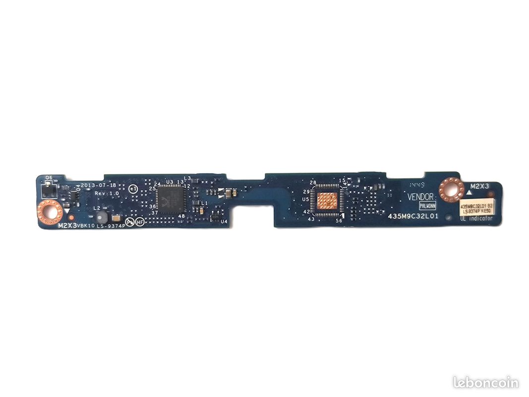

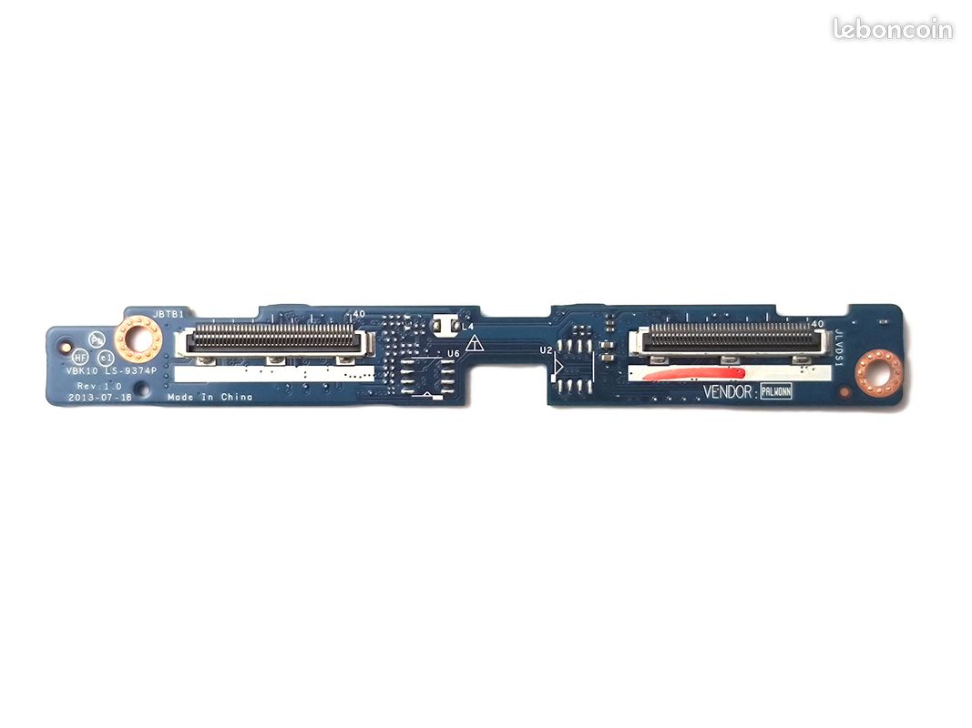

Keep in mind that for all the models stated the converter board looks something like this :
Carte LCD + Vis (board) - pour HP ZBook 17 G1 - VBK10 LS-9374P - Testé OK -  Accessoires informatique
So if you get the DC cables for your model you see that it connects to your board in a non standard eDP format = can't use that cable to connect to a standard eDP panel conenctor.
Also the zbook 17 g1 and g2 all have this converted board as they all have LVDS displays and the motherboard outputs eDP. Not sure why HP chose this approach, probably because eDP lcds were rare in 2013-2014.
so zbook 17 g1/g2 with 900p to 1080p screes have this board if you want a sure way to get your hands on one.
