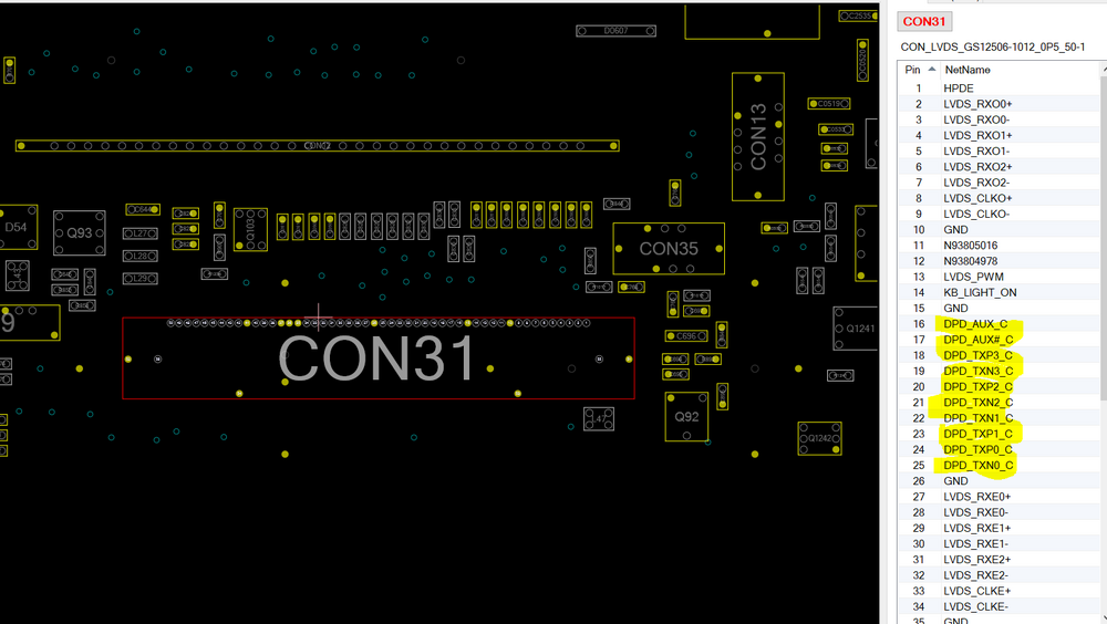

Here is my pinout. GND is connected to metal body on both ends.  Right paper is pinout for connector on laptop board. On left is standard 30 pin eDP output with my hadwritten numbers corresponding pins from mobo connector.

I *sacrificed* my dreamcolor cable to check pins used. I share here, so maybe someone may figure out what I missed. I'm investigating myself now.
X next to pin is from motherboard to LCD cable. Also, for future, P/N for 8560w dc cable is 350406400-11C-G
If you ask me, you need to find a 40 pin eDP screen’s schematics. As you can see from the DC cable all of the DP related wires are there. Maybe that’s the issue.
I have both 30 pin and 40 pin schematics, they're pretty standard. It also checks out that 4K screen with touch screen capability have separate flex cable for touch, separately from 40 pin LCD. Why I know ? Because I have such screen from tablet Zbook 🙂
EDIT: for 1080p we need only 2 pairs + aux channel in eDP, that is 30pin one is used for. For 2k-4k we need
correspondingly 3 pairs + aux and 4 pairs + aux. That's why I made another cable for 30 pin, because I needed to solder a lot less cables, easier on myself. Just to check out if my mod would work.
Dreamcolor uses all of lanes because it is 8 bit conversion to 10 bit, but with 1080p resolution. For same resolution output in LVDS (compared to eDP) you need twice as much lanes. eDP FHD takes 2 pairs + control channel, LVDS takes 4 differential pairs + control channel.
Thanks to AstroMan helping hand, we are figuring out what I missed. When I was writing answer to why it is not working and I don't have ideas, I had such code programmer duck moment ..! I have hypothesis to check, I may had mistaken LCDVCC to be panel supply line. My theory is to connect panel supply pins to +3.3V line instead of LCDVCC - I think it is just signal from MXM connector, it was used only in LVDS technology. But we all, you and me, have to wait till monday for next part of my troubleshotting... I took my modded cable but forgot to take eDP panels from job place 😞 so we wait till monday for news - do I fry my lovely HP or does it work.

So, it works with reduced channel width (the 30pin)?
Yes, FHD max. I tried to use 40 pin with 4K, but it didn't light up. It may be soldering error, though. Need to check again with multimeter.

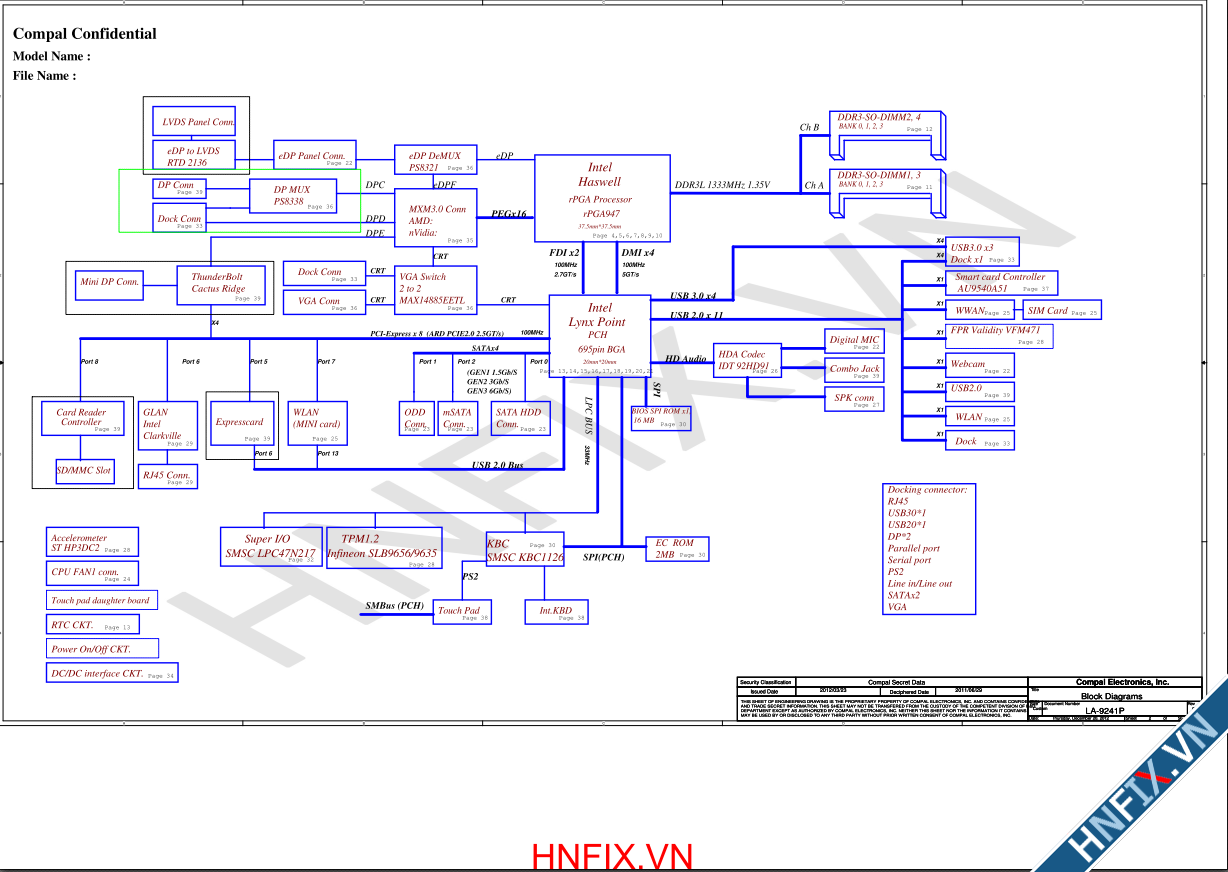

On 8/7/2025 at 5:55 AM, Vladka76 said:
Maybe it would be useful to look for hints in the ZBook 15 G1|G2 schematics - you wrote earlier that they have eDP cables and screens? 😉
Hello,
I've a Zbook 15 G2 with M2200, so I'm always curious to hear about possible upgrades. Had a look for the schematics for that model and found these.
So apparently,
Dp C is for both laptop and dock.
Dp D goes to the dock.
Dp E goes to TB.
eDP F goes to eDP/LVDS.
