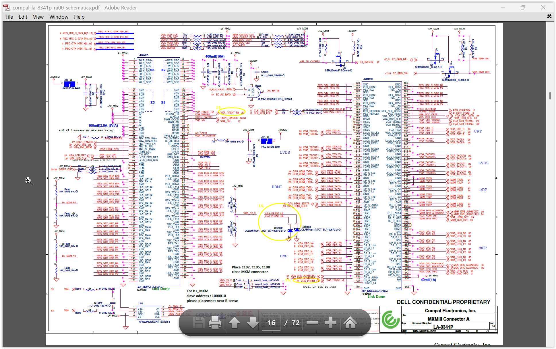

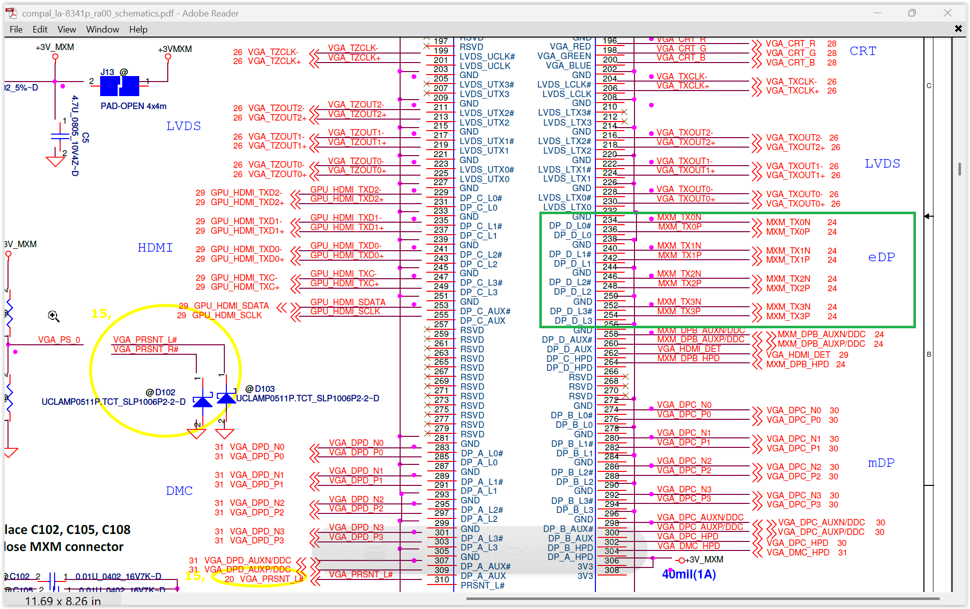

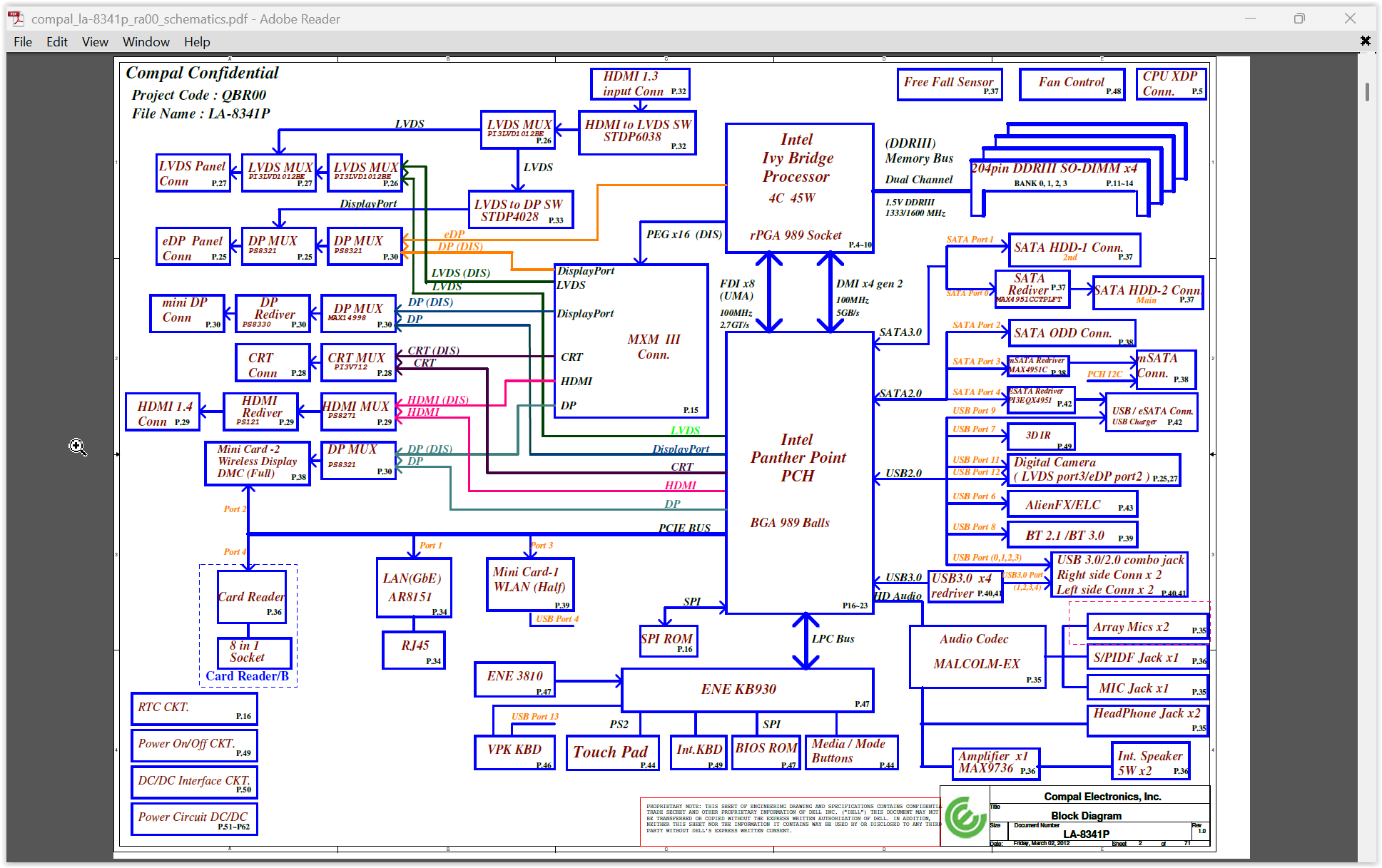

Actualy in AW17x r4 scheme is eDP connected to DP_D output on mxm conn ,as is on ZRT4080/90 datasheet. what i see. If eDP out not working  must be other problem there i think.

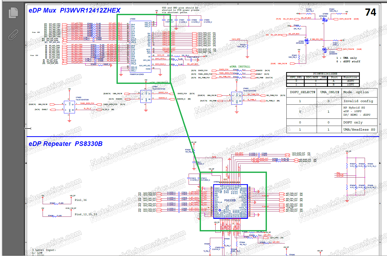

Maybe because the card doesn't have eDP lines. I tried every vbios. I have the schematics of my laptop, it's DP_D. Same goes for @ichime, this person has a ZBOOK G6 with eDP on port D and his 4090 doesn't work. Display only works on SG mode with Intel HD or without SG, it works with a compatible GPU in slot 1 for display.
Hi, yes i thing this is the main problem of all non working eDP-port by the way. Let me show on ZBook what i think going on.On compatibile cards there are several pins call OEM ,RSVD (img.1) and maybe more ,which is setting up the configuration thru by chipset which after is set all the multiplexer on the line from MXM-port D-gpu to eDP connector (img.2,2a). But on non-compatible card there are no functions on these pins(img.3). This is means no output on eDP port ,but on mxm pins (tx?-out)  yes (img.4) . Basically "if not any information from pin d-gpu-enable and from the others pins will not enable any mux switch on the line by the chipset.You have the schematics too you could check himself .

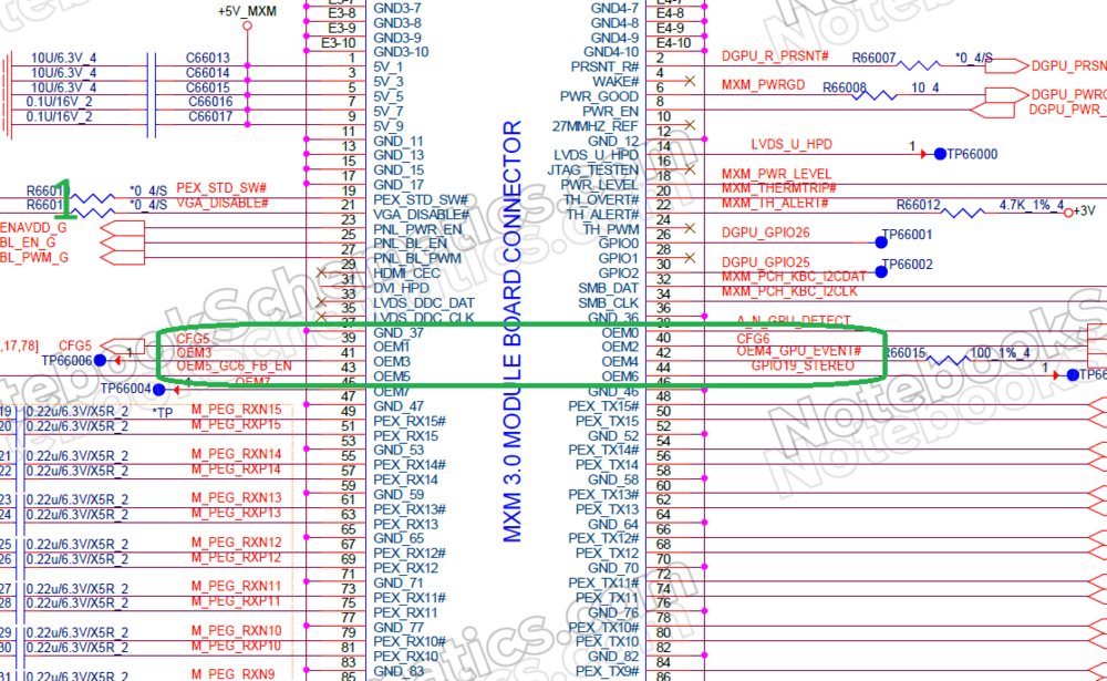

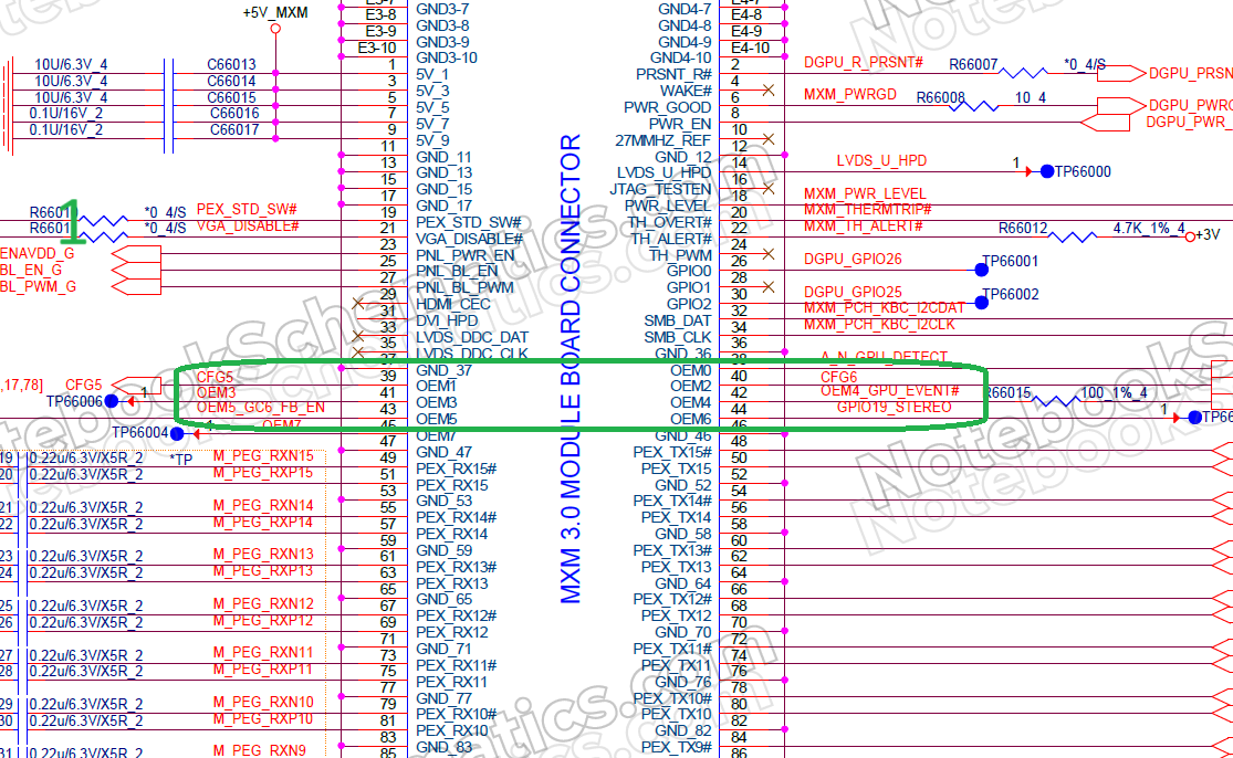

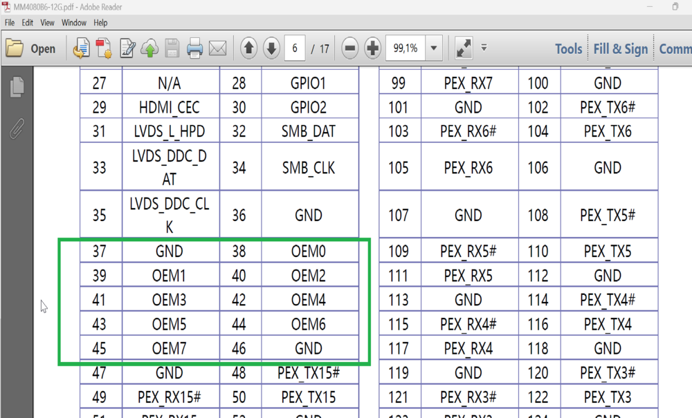

30 minutes ago, janepa said:

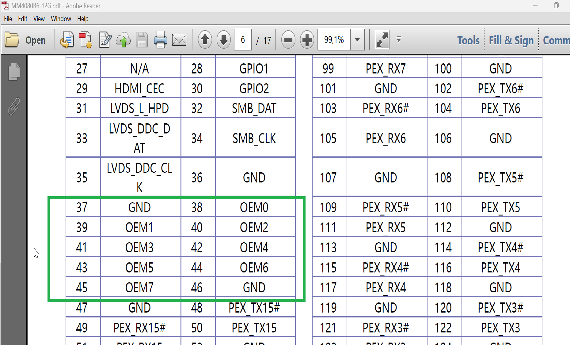

I found a ZRT, RTX 4060 MXM datasheet and there's also OEM pins. OEM0 TO OEM7
It also has some DP_D signals for eDP:
DP_D L0
DP_D L0#
DP_D L1
DP_D L1#
DP_D L2
DP_D L2#
DP_D L3
DP_D L3#
DP_D AUX
DP_D AUX#
DP_D HPD
I can't post any pictures because I am limited with the size of the files.

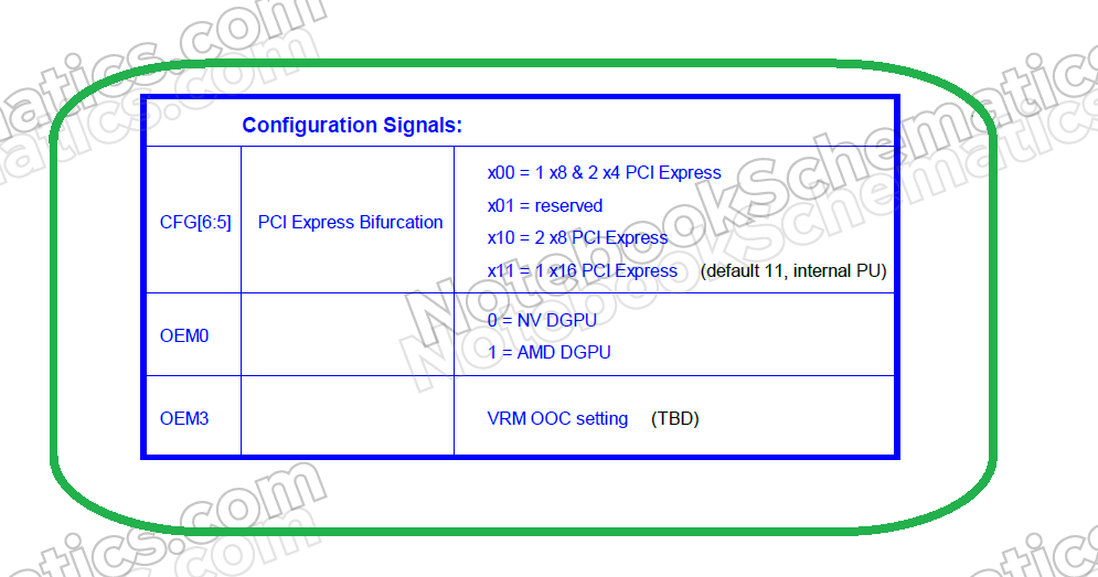

DP_D L0
DP_D L0#
DP_D L1
DP_D L1#
DP_D L2
DP_D L2#
DP_D L3
DP_D L3#
DP_D AUX
DP_D AUX#
DP_D HPD

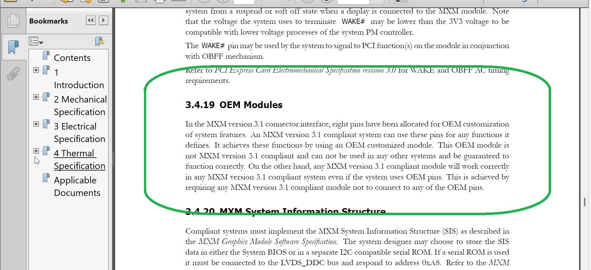

Yes,of course there are OEMs pins ,threre are on every mxm gpus ,but they do nothing ,because vbios of non-compatibile card do not care about these pins. And this is means "non working OEMs pins = non working notebook mux switch via chipset control" because the PCH and CPU have no idea about of non-compatible gpu card where is in mxm slot. Yes one things is visibility nvidia GFX in uefi bios and second is comunicating with PCH and CPU via these OEM pins.
