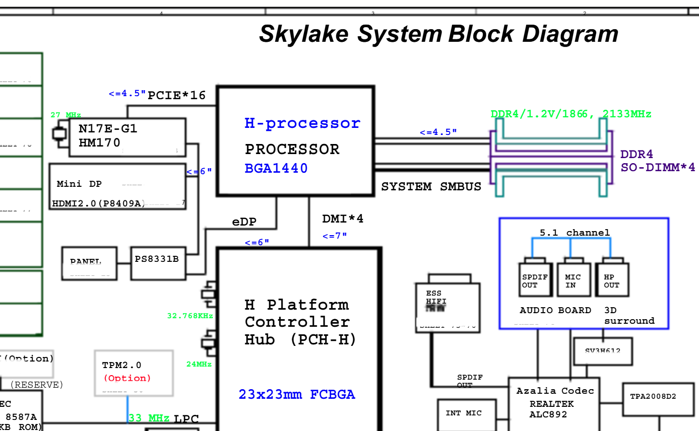

This is a screenshot of the block diagram of this clevo, as you can see the GTX 1060 is connected to a mux that then connects to the panel, just like on my Zbook 17 g3.
Even in NVIDIA control panel it shows that the card has 4 display outs, including the square connector (laptop display) however, when putting my laptop in discrete graphics mod in the BIOS, I get no picture on the internal diplay. The external HDMI works.

And yes..gpu needs to have the physical lanes attached to display out. The block diagram with display outs only shows the vbios config and not the hardware itself.
This is why cards like HP RTX work in eDP but ADLink etc do not from what I've seen.

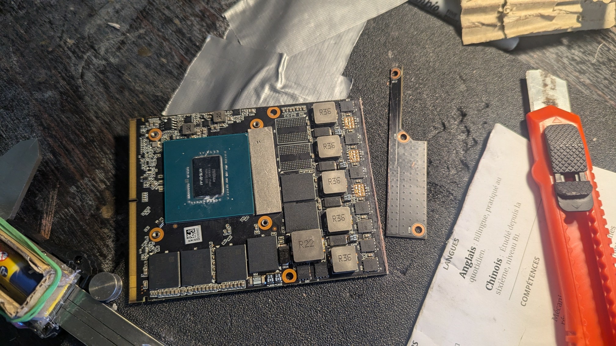

Here is a pic of the Zotac 1070
ZOTAC ZBOX MAGNUS EN1070のCPUをi7 6700Tに換装してみた | 自作とゲームと趣味の日々
The pcb is identical to my zotac 1060 MXM (pic below), especially near the resistor + capacitors next to the display outputs. The only change is the different GPU die.
I just neeed to figure out vBIOS eDP enabling. Heck my Zbook BIOS might be the problem if it's incompatible, I need to dig deeper.

Developer79 got my RTX 4070 MXM card!
Developer79 will test the card probably tomorrow on his Clevo P870 and tell me what's happening on his side! Will it do a blackscreen and only work thru DP, HDMI? Probably
If it does, how @Developer79can trigger the jumpers for the backlight? We'll probably know on this week!
About ZRT, still no answers since 5 days!

Hello, I have some news... it can work because...
Developer79 managed to make a standard RTX 4070 MXM run on his laptop with video driven thru his eDP screen!
Yes, the RTX 4070 MXM that wasn't working on my eDP screen, worked on his laptop!
Which is a clevo P870. For your information, the P870 and P570 both share the exact same MXM connector pinouts, so it means the card could finally display on my laptop's eDP display!
Developer79 did a few hardware modification on the MXM card and the eDP display began displaying from the card itself!
So yes, I was right about the backlight panel pins!
After, I need to test the card on the P570 but it sure will work 100%.
I don't know why X-VSION and ZRT didn't enable these pins? Like... Why add eDP on DP_D if it doesn't fully work in our laptop's internal eDP screen? eDP is widely used on laptops...

Hi,
my tests with my board showed me how everything works in general, so I already knew what to look out for.
When designing the circuit diagrams, I took into account many more scenarios than are actually needed. A lot of things can also be automated.
The bottom line is that it works and you can use the laptop normally with eDP as it was originally designed.
