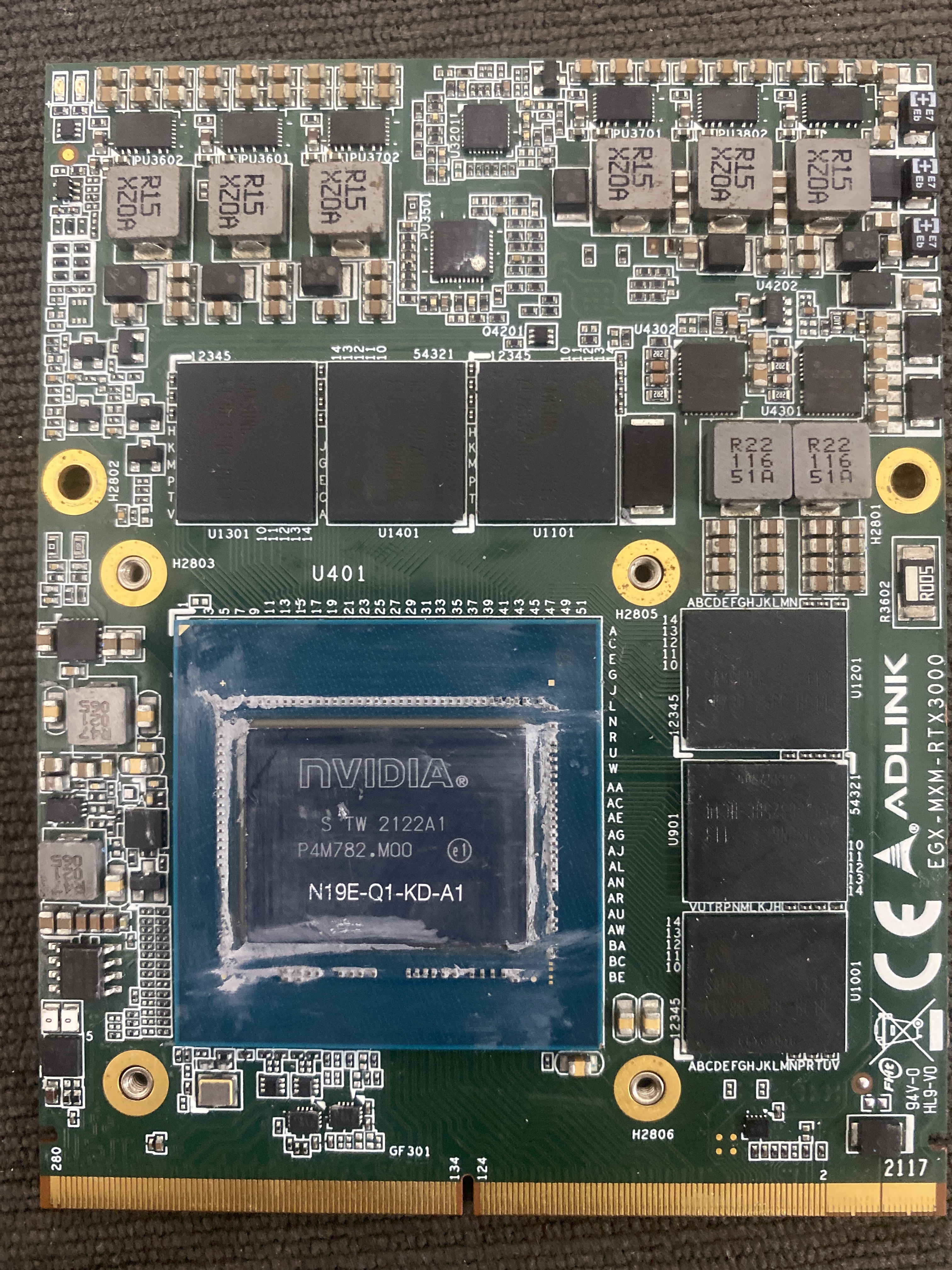

Hussain Alhadher Posted September 23 Posted September 23 Hi guys, My RTX 3000 suddenly shut the laptop off while gaming. Now the charger LED goes out immediately when I plug it into the laptop with the RTX installed. I tested with battery removed and i had the same issue I removed the RTX and the charger light stays on I plugged in my old 765m in and charger works normally So it looks like the fault is on the RTX 3000 itself. I don’t see any obvious burnt components. Could it be a shorted mosfet or capacitor or vrm component, and is this usually repairable? Alienware M17x R4: i7-3940XM | Quadro RTX 3000 | 32gb DDR3 RAM | 60Hz display
SuperMG Posted September 23 Posted September 23 1 hour ago, Hussain Alhadher said: Hi guys, My RTX 3000 suddenly shut the laptop off while gaming. Now the charger LED goes out immediately when I plug it into the laptop with the RTX installed. I tested with battery removed and i had the same issue I removed the RTX and the charger light stays on I plugged in my old 765m in and charger works normally So it looks like the fault is on the RTX 3000 itself. I don’t see any obvious burnt components. Could it be a shorted mosfet or capacitor or vrm component, and is this usually repairable? Maybe it's shorting between the heatsink and the GPU's components? Happened to me. Make sure to have a properly set heatsink with the correct thermal pads. No burn marks on the tiny capacitors? Was your GPU heavily thermal throttling before? If it's completely dead then... There are options to upgrade to a 120Hz display and to a better RTX 4060/4070 card.

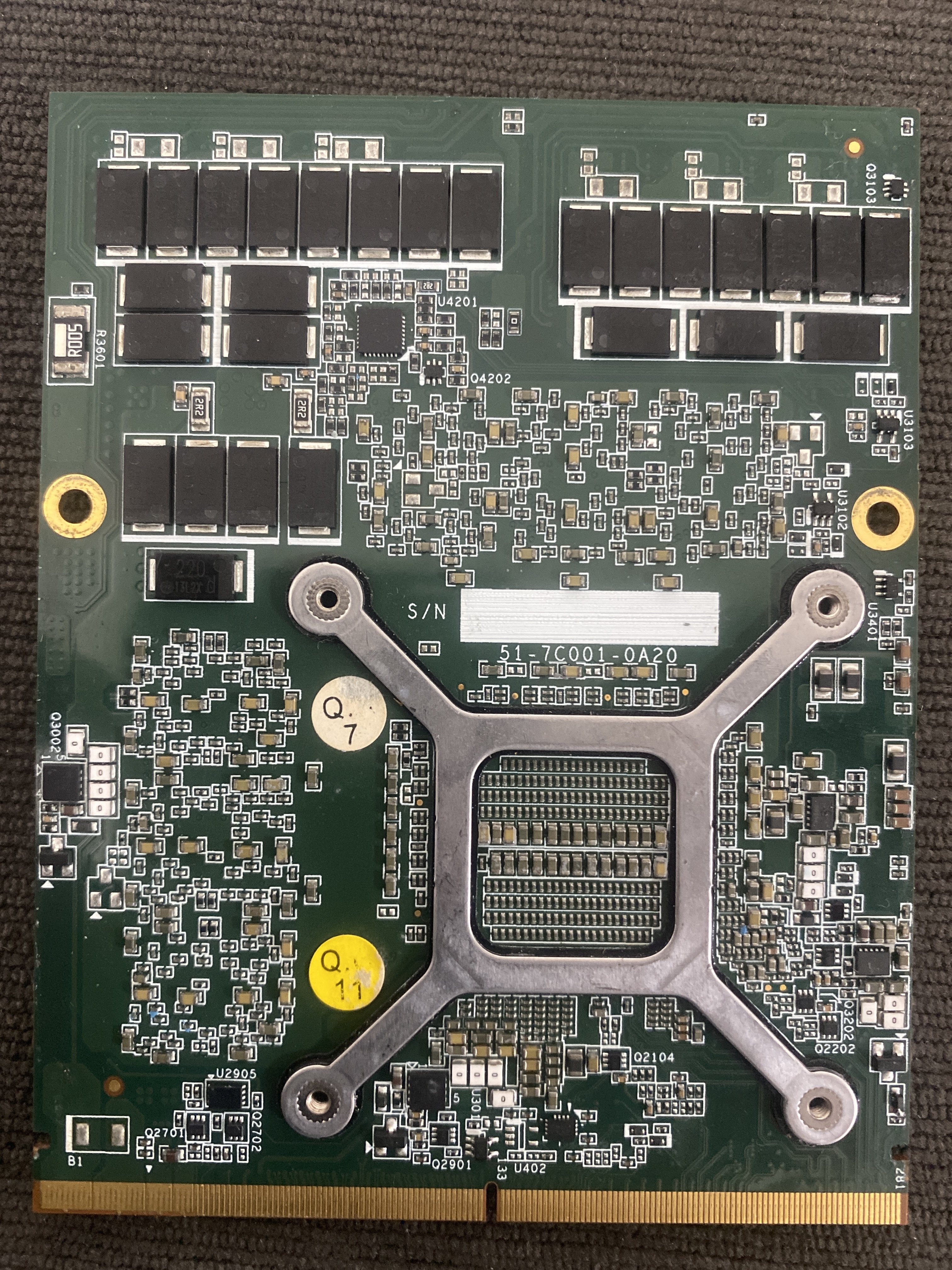

Hussain Alhadher Posted September 23 Author Posted September 23 I also thought it could be the heatsink, but I tested the RTX installed without the heatsink with the laptop powered off and just plugging in the charger still makes the charger LED shut off. With the RTX removed, or with my GTX 765M installed, the charger works normally. I don’t see any obvious burnt capacitors either. Before it died the GPU was usually around 68–72°C at 96–99% load, so it was performing well and wasn’t heavily thermal throttling. So I’m thinking there may be a short somewhere on the RTX board itself. Alienware M17x R4: i7-3940XM | Quadro RTX 3000 | 32gb DDR3 RAM | 60Hz display
SuperMG Posted September 23 Posted September 23 19 minutes ago, Hussain Alhadher said: I also thought it could be the heatsink, but I tested the RTX installed without the heatsink with the laptop powered off and just plugging in the charger still makes the charger LED shut off. With the RTX removed, or with my GTX 765M installed, the charger works normally. I don’t see any obvious burnt capacitors either. Before it died the GPU was usually around 68–72°C at 96–99% load, so it was performing well and wasn’t heavily thermal throttling. So I’m thinking there may be a short somewhere on the RTX board itself. Can you use some kapton tape to cover the X-bracket metallic zone? And retry? Does your motherboard still have the black plastic filter next to the MXM slot? It's to avoid short-circuit.
Hussain Alhadher Posted September 23 Author Posted September 23 The black plastic insulation next to the MXM slot is still there. I also insulated the X-bracket area with a tape but the charger still trips. With the RTX removed or the GTX 765M installed, the charger works normally. So it looks more like a short on the RTX board itself. Alienware M17x R4: i7-3940XM | Quadro RTX 3000 | 32gb DDR3 RAM | 60Hz display
SuperMG Posted September 23 Posted September 23 2 minutes ago, Hussain Alhadher said: The black plastic insulation next to the MXM slot is still there. I also insulated the X-bracket area with a tape but the charger still trips. With the RTX removed or the GTX 765M installed, the charger works normally. So it looks more like a short on the RTX board itself. You should look with the multi-meter, every components then... But is it worth it? Did you buy the card brand new or used? How was it used before?

janepa Posted September 24 Posted September 24 18 hours ago, Hussain Alhadher said: So it looks like the fault is on the RTX 3000 itself. I don’t see any obvious burnt components. Could it be a shorted mosfet or capacitor or vrm component, and is this usually repairable? Hi It could be any of those of course. I can try to help you in the simplest way I know. If this is still relevant. Alienware M18x R1 i7-2720xm-32GB-Adlink RTX5000 Alienware M18x R2 i7-3920xm-32GB-RTX4090 (still in testing) with the latest bios version. A14 specially modified updated and unlocked by me 😎 Asus ROG Zephyrus G14 AMD Ryzen 9 7940HS-32GB-RTX4060
Hussain Alhadher Posted September 24 Author Posted September 24 59 minutes ago, janepa said: Hi It could be any of those of course. I can try to help you in the simplest way I know. If this is still relevant. Hi, yes it’s still relevant. I’d really appreciate the help. Right now im using my old 765m Should i go to a repair shop? What would you suggest I check first? Alienware M17x R4: i7-3940XM | Quadro RTX 3000 | 32gb DDR3 RAM | 60Hz display
Eban Posted September 24 Posted September 24 A very hard visual check will most often NOT find the fault, even with a microscope.....you can get lucky but don't count on it. Try your phone on magnify and go over EVERYTHING. Twice. Without being able to power the laptop with card installed means you can't even use heat to pinpoint a shorted power rail component. A variable power supply would let you low power the card by itself to find a short, but I don't recommend you do that first. A cheap multimeter will get you a better idea. Thunderchild // Lenovo Legion Y740 17" i7-9750H rtx2080maxQ win10LTSC RainBird // Alienware 17 (Ranger) i7-4910mq gtx860m win8.1 JunkDog // Desktop Asrock 660M i3-12100F ARC A580 win10LTSC
JadeRover Posted September 24 Posted September 24 13 minutes ago, Hussain Alhadher said: What would you suggest I check first? Seing as your charger shut's off immediately, it is safe to assume that the main power rail (+19v) of your MXM gpu is shorted. The charger supplies the MXM slot directly, making it cut out with GPU installed = the MXM card is main power rail shorted. This is either due to a capacitor that shorted itself or a high side mosfet short, the high side mosdfet are driving a secondary power rail (+VCC_CORE, +VCC_VRAM, +VCC_PEX, +VCC_1.8v) Best case is a capactitor as it can't damage anything else, mosfet is more problematic as the secondary power rails I mentionned are all at <2v and they suddenly received +19v for a few milliseconds, this is enough to internally destroy the core or the vram chips. I would highly recommend you get a multimeter, even at your local hardware store it will be less than <10$ and very useful for future projects/life. With the multimeter you can trace down the short and then you will need a controlled power source, such as a lab bench PSU to inject a small voltage of 1v @ 2-3 Amps so that the shorted components warms up. Then the component must be replaced (this is more complicated) You can also go to a repair shop and tell them you think it is main power rail short because of charger cutting out immediately, if they do actual motherboard level repairs (not a given) they should be able to confirm it and tell you if the card is fixable. 1 1 Precision M6700 : i7-3740QM | P3000 6gb engineering vbios | 20gb DDR3 1600Mhz | FHD ips dreamcolor | delta fans Zbook 17 g3 : i7-6820HQ -75mv | M3000m 4gb | 16gb DDR4 2400Mhz | FHD ips Precision 7720 : i7-6820HQ -80mv & 102.7mhz BCLK| Zotac GTX1060 6gb, 100w OC vbios | 16gb DDR4 3011Mhz | 1440p165hz (upgrad) Zbook 17 g5 : i7-8850H, -140mv | P5200 16gb | 32gb DDR4 2666Mhz | FHD IPS
janepa Posted September 24 Posted September 24 Okay, first we need any ordinary contact cleaner spray based on isopropyl alcohol. There are tons of options on the market, but it has to be a pressurized can not a manual sprayer. Second you’ll need two or better three nearly dead AA or AAA 1.5V battery cells like from a TV remote control plus two pieces of any kind of wire or even a paper clip will do. If it's (in the best case) just a shorted ceramic capacitor it can be removed mechanically for example with a small screwsdriver and no soldering is needed. There are lots of them and the card can operate without one as well. No worries. Any ordinary inexpensive basic multimeter is obviously a big advantage, as other forum users have mentioned here. 1 Alienware M18x R1 i7-2720xm-32GB-Adlink RTX5000 Alienware M18x R2 i7-3920xm-32GB-RTX4090 (still in testing) with the latest bios version. A14 specially modified updated and unlocked by me 😎 Asus ROG Zephyrus G14 AMD Ryzen 9 7940HS-32GB-RTX4060
