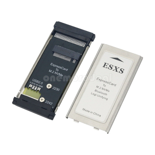

nforce4max Posted July 14 Share Posted July 14 6 hours ago, AstroMan said: Thank you!! That's seriously awesome! Would love to replicate it for 8560w, seems logical and 100% compatible. Funny those old laptops are more modular than modern modular brands. Great laptops really. Anyone tried these adapters for 2230/2242 nvme to expresscard 34? Kind of makes sense for hotswap storage or test system drive, hopefully not at 2.5Gbit speeds of Expresscard I have and hotswap works however expect an blue screen once in a while. The performance isn't great being pcie 1x at 2.0 but still handy for moving files on/off much older laptops while serving as extra storage. The adapter itself could be better when it comes to build quality. 1 Link to comment Share on other sites More sharing options...

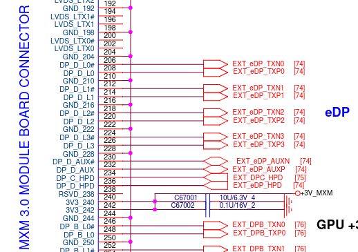

SuperMG Posted July 16 Share Posted July 16 On 7/14/2025 at 7:25 AM, nforce4max said: I believe that is the D version. I got the RTX Turing to work on eDP with my laptop from 2012. I still am confused about the DP_C port... For example, everyone said Alienware M17X R4 eDP is DP_C. But when I tried the P5200 on it, it doesn't boot and does 8 beeps. On my Clevo it works... So my clevo isn't DP_C? Then what is it? DP_A? DP_B? Both quadro cards are coming from Zbook G5/G6. Do you know what eDP port do they use? Link to comment Share on other sites More sharing options...
Daedalus Posted July 16 Share Posted July 16 4 hours ago, SuperMG3 said: I got the RTX Turing to work on eDP with my laptop from 2012. I still am confused about the DP_C port... For example, everyone said Alienware M17X R4 eDP is DP_C. But when I tried the P5200 on it, it doesn't boot and does 8 beeps. On my Clevo it works... So my clevo isn't DP_C? Then what is it? DP_A? DP_B? Both quadro cards are coming from Zbook G5/G6. Do you know what eDP port do they use? Which CPU generation was your 2012 laptop? Just curious if the Turing Gen GPU cards are matched to certain CPU generations. Therfore assume the MXM port isnt a limitation if you can then run Maxwell (original) then Pascal & Turing. I'd love to try a Turing Card in the 8750W however the later cards i think are bigger than the 965/980M's footprint and also i think the LVDS "normal screen" will only run 980 at best. Found this wiki if of use. Mobile PCI Express Module - Wikipedia Link to comment Share on other sites More sharing options...
AstroMan Posted July 16 Share Posted July 16 4 hours ago, SuperMG3 said: I got the RTX Turing to work on eDP with my laptop from 2012. I still am confused about the DP_C port... For example, everyone said Alienware M17X R4 eDP is DP_C. But when I tried the P5200 on it, it doesn't boot and does 8 beeps. On my Clevo it works... So my clevo isn't DP_C? Then what is it? DP_A? DP_B? Both quadro cards are coming from Zbook G5/G6. Do you know what eDP port do they use? Whether a mxm card works or not is a mixture of compatible firmware (vbios, efi etc) and hardware (traces). DP_C stands for Display Port "channel C" sooo, if your hardware (laptop) has motherboard traces for channel C and is configured in firmware to do so, it will work with a graphics card that's also channel C DP enabled. To get it working in M17X R4, you probably need 120Hz screen (eDP cable screen), PEG mode (bypass intel - default for 120Hz), pure UEFI (no CSM - at Maxwell and later cards) and some luck with a card (compatibility). You can always get a ch341a @1.8v and backup the vbios prior to opening that can of worms (flashing vbios). Mind you, it's risky and just because you flash "compatible" for your laptop vbios, doesn't mean that the vendor implemented all the traces into the GPU pcb. Also ch341a extracted vbios will be different to gpuz extracted vbios. Link to comment Share on other sites More sharing options...

SuperMG Posted July 16 Share Posted July 16 31 minutes ago, AstroMan said: Whether a mxm card works or not is a mixture of compatible firmware (vbios, efi etc) and hardware (traces). DP_C stands for Display Port "channel C" sooo, if your hardware (laptop) has motherboard traces for channel C and is configured in firmware to do so, it will work with a graphics card that's also channel C DP enabled. To get it working in M17X R4, you probably need 120Hz screen (eDP cable screen), PEG mode (bypass intel - default for 120Hz), pure UEFI (no CSM - at Maxwell and later cards) and some luck with a card (compatibility). You can always get a ch341a @1.8v and backup the vbios prior to opening that can of worms (flashing vbios). Mind you, it's risky and just because you flash "compatible" for your laptop vbios, doesn't mean that the vendor implemented all the traces into the GPU pcb. Also ch341a extracted vbios will be different to gpuz extracted vbios. I can't find any diagrams about HP Zbook G5/G6 if they are using DP_C or I don't know which port. Not even finding my own laptop's diagram too... 35 minutes ago, Daedalus said: Which CPU generation was your 2012 laptop? Just curious if the Turing Gen GPU cards are matched to certain CPU generations. Therfore assume the MXM port isnt a limitation if you can then run Maxwell (original) then Pascal & Turing. I'd love to try a Turing Card in the 8750W however the later cards i think are bigger than the 965/980M's footprint and also i think the LVDS "normal screen" will only run 980 at best. Found this wiki if of use. Mobile PCI Express Module - Wikipedia My CPU is a Xeon E5 2690 v2, same level as an i9 9880H. Link to comment Share on other sites More sharing options...
AstroMan Posted July 16 Share Posted July 16 21 minutes ago, SuperMG3 said: I can't find any diagrams about HP Zbook G5/G6 if they are using DP_C or I don't know which port. Not even finding my own laptop's diagram too... Those diagrams and schematics are probably made for engineers and hide behind NDA Unless someone knows and shares, it's usually people like us who tinker and probe the traces in the darkness haha Outside of learning how to do all the vbios VBT magic (which takes time and effort), step below is to get your hands dirty and plunge money down the drain by buying gpus, flashing them and reporting what works in what combination. No guarantee if it will ever work, it wasn't designed to from factory. Not that this was ever an issue Link to comment Share on other sites More sharing options...
SuperMG Posted July 16 Share Posted July 16 (edited) 9 minutes ago, AstroMan said: Those diagrams and schematics are probably made for engineers and hide behind NDA Unless someone knows and shares, it's usually people like us who tinker and probe the traces in the darkness haha Outside of learning how to do all the vbios VBT magic (which takes time and effort), step below is to get your hands dirty and plunge money down the drain by buying gpus, flashing them and reporting what works in what combination. No guarantee if it will ever work, it wasn't designed to from factory. Not that this was ever an issue Already tried that. 4070 on DP_D, other VBIOSes are bricking the card. Sad I can't know what port the HP Zbook G5 G6 used because they do share the same potential port with my clevo laptop... Edited July 16 by SuperMG3 Link to comment Share on other sites More sharing options...

SuperMG Posted July 16 Share Posted July 16 1 hour ago, GuitarG said: A lot of free time + boredoom at job = me reparing not working motherboard for parts. Unfortunately, 40pin cable didn't worked. Not sure why, LCD may be broken or I missed something important. Fortunately, I have another cable, Im gonna try make much simpler 30pin cable. I have about 10 eDP 30pin LCDs, so we will be sure this time. D channel DP driver G6 eDP Thank you. Wait a second. So my laptop is DP_D? Because the P5200 from HP worked and the RTX 3000 Turing from HP worked too on the eDP. But on Alienware M17X R4 eDP the P5200/RTX 3000 didn't work, 8 beeps. Very strange, why does the RTX 4070 MXM doesn't work on my laptop then? The 4070 has DP_D for eDP Link to comment Share on other sites More sharing options...
AstroMan Posted July 16 Share Posted July 16 1 hour ago, SuperMG3 said: Thank you. Wait a second. So my laptop is DP_D? Because the P5200 from HP worked and the RTX 3000 Turing from HP worked too on the eDP. But on Alienware M17X R4 eDP the P5200/RTX 3000 didn't work, 8 beeps. Very strange, why does the RTX 4070 MXM doesn't work on my laptop then? The 4070 has DP_D for eDP If you check docs, M17X R4 (Voyager) also has DP_D on eDP. This might sound crazy buuuuut unplug the eDP screen on M17X R4 and see if it outputs to external via HDMI and/or at least stops beeping. Maybe the screen is the issue all along. 8 Beeps in AW means more like "dont wanna" instead of "the gpu is dying of death". Baby steps. Link to comment Share on other sites More sharing options...
SuperMG Posted July 16 Share Posted July 16 26 minutes ago, AstroMan said: If you check docs, M17X R4 (Voyager) also has DP_D on eDP. This might sound crazy buuuuut unplug the eDP screen on M17X R4 and see if it outputs to external via HDMI and/or at least stops beeping. Maybe the screen is the issue all along. 8 Beeps in AW means more like "dont wanna" instead of "the gpu is dying of death". Baby steps. I tried that too back then, even if you unplug the screen and even if you plug DP, HDMI and even VGA, it still does 8 beeps. Also online I saw it was DP C for eDP Link to comment Share on other sites More sharing options...
SuperMG Posted July 16 Share Posted July 16 (edited) 8 hours ago, GuitarG said: 8 hours ago, SuperMG3 said: Already tried that. 4070 on DP_D, other VBIOSes are bricking the card. Sad I can't know what port the HP Zbook G5 G6 used because they do share the same potential port with my clevo laptop... Expand D channel DP driver G6 eDP I found this diagram but doesn't help lol https://www.yumpu.com/en/document/read/50891087/clevo-p270wmunlocked-data-sheet-gadget Edit found something. DP_A = DP/DVI? DP_B = DP DP_C = HDMI DP_D = eDP But why does the DP_D for eDP on the 4070 doesn't work tho? But it works for RTX 3000 Turing Edited July 16 by SuperMG3 Link to comment Share on other sites More sharing options...
