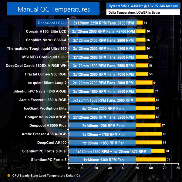

Yeah, I suspect the low pump speed plays a role here, precisely because I use custom fans meaning that the water coming out of the rad is really cool, by AIO standards. I looked at Tom's reviews and they said, wow - this AIO (another DeepCool model with 2550rpm pump) is awesome because it can handle 315W with the 13900K. Well, my setup as can handle 320-330W with a 2000RPM pump (with fresh paste).
I was sizing up this AFII AIO for the 12900KS, not the 13900K, and didn't pay attention to the pump speed. Arctic managed to get away with a slow pump due to the oversized radiator. Ideally I would like something with a thick radiator and a fast pump lol. If no such product exists, then I guess it will be time to start putting together a custom loop setup.
Edit: yeah the AFII 360 doesn't cut it anymore these days. 9C worse than the DeepCool LS720 (at £120 it's tempting):

Remember reviews with different Cpu's can provide different temp results.
2 hours ago, Etern4l said:
For now I'm reviewing this AFII 360 AIO. For starters, it has a 2000 RPM pump... whereas some other offerings on the market come with a ~3000rpm pump. As @tps3443 was saying, pump speed is key. For example, DeepCool LS720 comes with a 3100RPM pump, which could provide material improvement potentially. Need to read up more.
I don't think the pump or pump speed is the problem. Has to be the cold plate fits on the IHS. And you are looking on an AIO that won't bring you much...
And the results from the AFII is with the weak less noisy fans that follow the AIO.
I agree with that. While the volume of water getting pumped through the block matters, fit is more important. If it cannot transfer the heat off of the die or IHS due to poor contact then running more water through the block will accomplish nothing. The fact that the phase change pad worked better than thermal paste for a period of time, but ultimately failed, suggests there is a problem with fit and/or contact. If the fit is poor enough, liquid metal might not provide any help.

https://www.kitguru.net/components/cooling/luke-hill/deepcool-ls720-360mm-aio-liquid-cooler-review/2/
Agree the fit could be a problem, but not sure what to do about that. Actually another AIO could be a solution, especially given that the fitting mechanism on the AFII is not rated too highly. I'm not sure if it's worth lapping the coldplate.
Logically the pump speed (flow, to be more precise - which very few manufacturers quote) should play a role, right? If you have 50% more water flow, that should materially affect the heat exchange especially if the coolant temp is around ambient. Also, from what I can see the pump block on this and similar AIOs is literally 2-3x the size of the pump block on the AFII. There is also the matter of coldplate size - the one on AFII is quite small, probably further reducing the heat exchange.
There is a lot of variance in the reviews, as you can see from the link above. I have to say, I am a little suspicious when I see reviews where the Corsair H150i (nothing special specs-wise) takes all the top spots lol
Besides that DC LS720 there are also a couple other 3000RPM pump AIO options which seem to perform similarly:
* EKWB Nucleus I believe, the current model
* Thermaltake Toughliquid Ultra 360
I will have a think. A bit of unwelcome painful guesswork and hassle to be honest.
