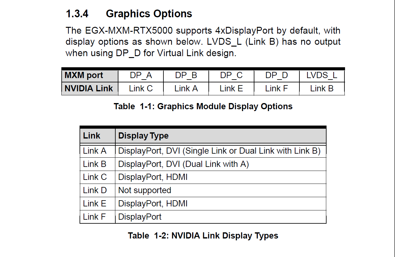

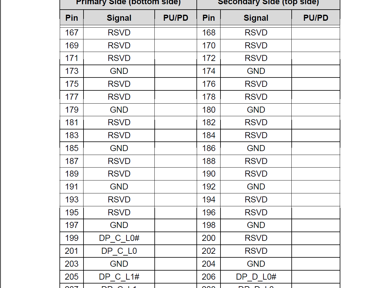

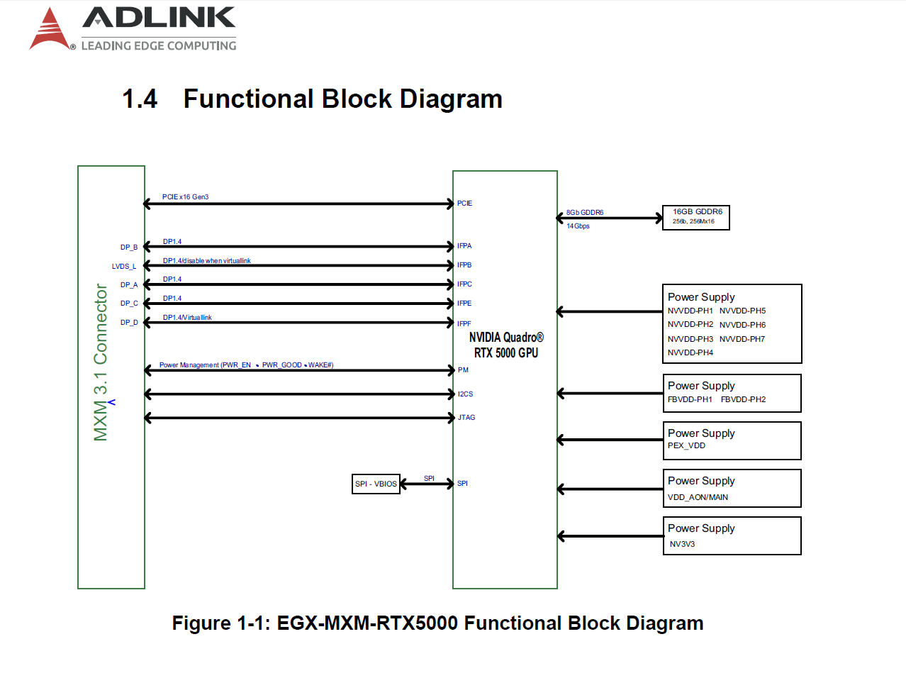

SuperMG Posted August 17, 2025 Posted August 17, 2025 2 hours ago, sliderfra said: It's genuine MXM so 3.3V is mandatory, but you have it on the last pins. As you can see on adlink AD5000 mxm, many pins are N/A (non applicable so non wired). There are 4 DP lines but absolutely NO edp wired. Most probably your RTX4k series are non wired either. Turing & Ampere mxm cards don't have EDP wired either... That's why standard MXM RTX 3000 has to use OPTIMUS, whereas HP RTX can bring signal to edp screen. If you look at the Intel Xe mxm pinout, you may see LVDS crossed (so most probably N/A) and EDP_D pins. EGX-MXM-ADA_Series_50M_7C008_1000_10.pdf 1.9 MB · 0 downloads The pdf you gave the DP_D is DP. It could work with eDP but you have to mod to bring the brightness. Without mods, eDP doesn't work for the cards in the pdf. The RTX 4050/4060 from ZRT have eDP on port D but my lap doesn't have the 3V3 power for the pin 240 and 242
SuperMG Posted August 17, 2025 Posted August 17, 2025 14 hours ago, sliderfra said: It's genuine MXM so 3.3V is mandatory, but you have it on the last pins. As you can see on adlink AD5000 mxm, many pins are N/A (non applicable so non wired). There are 4 DP lines but absolutely NO edp wired. Most probably your RTX4k series are non wired either. Turing & Ampere mxm cards don't have EDP wired either... That's why standard MXM RTX 3000 has to use OPTIMUS, whereas HP RTX can bring signal to edp screen. If you look at the Intel Xe mxm pinout, you may see LVDS crossed (so most probably N/A) and EDP_D pins. EGX-MXM-ADA_Series_50M_7C008_1000_10.pdf 1.9 MB · 1 download Why are the LVDS and VGA pins on RSVD or N/A?

janepa Posted August 18, 2025 Posted August 18, 2025 On 8/17/2025 at 8:29 AM, sliderfra said: It's genuine MXM so 3.3V is mandatory, but you have it on the last pins. As you can see on adlink AD5000 mxm, many pins are N/A (non applicable so non wired). There are 4 DP lines but absolutely NO edp wired. Most probably your RTX4k series are non wired either. Turing & Ampere mxm cards don't have EDP wired either... That's why standard MXM RTX 3000 has to use OPTIMUS, whereas HP RTX can bring signal to edp screen. If you look at the Intel Xe mxm pinout, you may see LVDS crossed (so most probably N/A) and EDP_D pins. EGX-MXM-ADA_Series_50M_7C008_1000_10.pdf 1.9 MB · 2 downloads Yes it´s true, but don´t forget please to a Dual Link-Mode of DP-out . Alienware M18x R1 i7-2720xm-32GB-Adlink RTX5000 Alienware M18x R2 i7-3920xm-32GB-RTX4090 (still in testing) with the latest bios version. A14 specially modified updated and unlocked by me 😎 Asus ROG Zephyrus G14 AMD Ryzen 9 7940HS-32GB-RTX4060
SuperMG Posted August 18, 2025 Posted August 18, 2025 15 minutes ago, janepa said: Yes it´s true, but don´t forget please to a Dual Link-Mode of DP-out . Yeah but your card has DP. ZRT has eDP, that's different. You might buy the RTX 5000 from HP because it has eDP

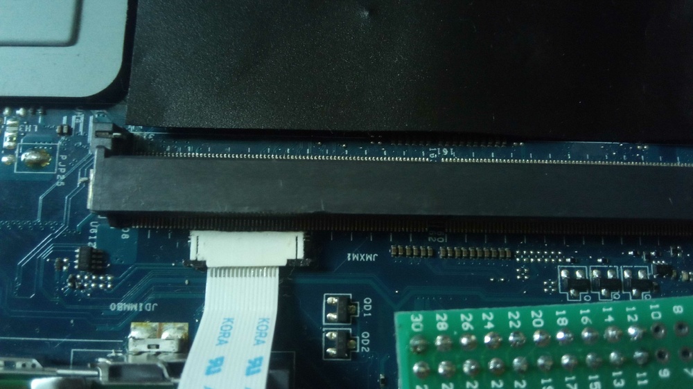

SuperMG Posted August 18, 2025 Posted August 18, 2025 (edited) On 8/18/2025 at 11:51 AM, janepa said: Yes it´s true, but don´t forget please to a Dual Link-Mode of DP-out . I did look between my mxm connector and the ZRT 4060 signals and I again found something. Are the pins 23, 25 and 27 important? Because on the ZRT RTX 4060 they are all in N/A On my connector it's all PNL_ signals. (Like PNL_BL_EN) Like does PNL_BL_PWM mean Panel Back Light PWN? Because X-VSION and ZRT are lacking it What are these? Modulation clocks? Some news: ZRT told me their Quadro A2000M and RTX 3050M are eDP compatible like the 4050/4060/4070... but on their specs, I see DP 1.4+, not eDP. Kinda strange no? Edited August 19, 2025 by SuperMG
sliderfra Posted August 19, 2025 Posted August 19, 2025 On 8/18/2025 at 9:22 PM, SuperMG said: I did look between my mxm connector and the ZRT 4060 signals and I again found something. Are the pins 23, 25 and 27 important? Because on the ZRT RTX 4060 they are all in N/A On my connector it's all PNL_ signals. (Like PNL_BL_EN) Like does PNL_BL_PWM mean Panel Back Light PWN? Because X-VSION and ZRT are lacking it What are these? Modulation clocks? Some news: ZRT told me their Quadro A2000M and RTX 3050M are eDP compatible like the 4050/4060/4070... but on their specs, I see DP 1.4+, not eDP. Kinda strange no? it's panel Backlight PWM, should PWM is used on the LCD (quite seldom, unless it's OLED display)
SuperMG Posted August 19, 2025 Posted August 19, 2025 4 minutes ago, sliderfra said: it's panel Backlight PWM, should PWM is used on the LCD (quite seldom, unless it's OLED display) Hello. I compared the AETINA GTX 1060/1070 schematics and my MXM connector schematics. They both have the PNL_BL_EN PNL_PWR_EN PNL_BL_PWM But on the ZRT/X-VSION cards they have them set to N/A. Why? I'm sure they are needed. I looked at my eDP connector and I see the PANEL signals. (_EN and _PWM signals)

janepa Posted August 19, 2025 Posted August 19, 2025 On 8/18/2025 at 9:22 PM, SuperMG said: I did look between my mxm connector and the ZRT 4060 signals and I again found something. Are the pins 23, 25 and 27 important? Because on the ZRT RTX 4060 they are all in N/A On my connector it's all PNL_ signals. (Like PNL_BL_EN) Like does PNL_BL_PWM mean Panel Back Light PWN? Because X-VSION and ZRT are lacking it What are these? Modulation clocks? Some news: ZRT told me their Quadro A2000M and RTX 3050M are eDP compatible like the 4050/4060/4070... but on their specs, I see DP 1.4+, not eDP. Kinda strange no? Good point. These pins are important. PNL_PWR _EN - enabling power source to LCD PNL_BL_EN - on/off LCD PNL_BL_PWM - pwm duty cycle I think there isn´t nothing terrible to solve it. The first and second maybe will be a TTL logic so level high it is needed (1.8v-3.3v). PNL_BL_PWM - first i try 3.3v = 100% duty cycle 1 Alienware M18x R1 i7-2720xm-32GB-Adlink RTX5000 Alienware M18x R2 i7-3920xm-32GB-RTX4090 (still in testing) with the latest bios version. A14 specially modified updated and unlocked by me 😎 Asus ROG Zephyrus G14 AMD Ryzen 9 7940HS-32GB-RTX4060
SuperMG Posted August 19, 2025 Posted August 19, 2025 17 minutes ago, janepa said: Good point. These pins are important. PNL_PWR _EN - enabling power source to LCD PNL_BL_EN - on/off LCD PNL_BL_PWM - pwm duty cycle I think there isn´t nothing terrible to solve it. The first and second maybe will be a TTL logic so level high it is needed (1.8v-3.3v). PNL_BL_PWM - first i try 3.3v = 100% duty cycle Thanks. I asked ZRT if they can enable them. They did use these pins on their GTX 1070M and 1660TiM (even thought they don't have eDP).. Here's where the pins are relied on my eDP conn. PNL_PWR_EN for pin PLVDD PNL_BL_PWM for pin PNL_BKLPWM PNL_BL_EN for pin PANEL_EN

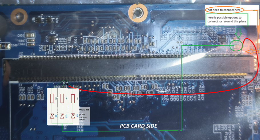

SuperMG Posted September 1, 2025 Posted September 1, 2025 On 7/7/2025 at 12:04 PM, SuperMG said: No EDP compatibility on 4070,4080,4090. 4050,4060,4070 eDP YES only if MXM port is modded. 3060, 3070, 3080 could also work, although they have DP on port D, it'll theorically work. If anyone wants to try, go ahead and do what the picture shows. Developer79 tested this wiring setup and got the 4070 from XVSION to work with his eDP screen. @janepa
janepa Posted September 8, 2025 Posted September 8, 2025 On 9/2/2025 at 12:03 AM, SuperMG said: 4050,4060,4070 eDP YES only if MXM port is modded. 3060, 3070, 3080 could also work, although they have DP on port D, it'll theorically work. If anyone wants to try, go ahead and do what the picture shows. Developer79 tested this wiring setup and got the 4070 from XVSION to work with his eDP screen. @janepa Good work, but for safety maybe could add some schottky diode and resistor for current limitation when anything will be happen. And keep in mind please ,that modification basically work on opposite principle (signal is not from gpu,but to gpu and who knows what can be happen).Maybe this three pins on gpu isolating with capton tape will be good. On almost the same principle also works to switch multiplexers from Lo state (defeault PCH iGpu) to Hi state dGPU thru pin DGPU_SELECT. Who have a eDP platform and not OEM gpu card on the right DP pins on mxm connector is step forward for you. Who have LVDS it must create a new lines as i. For me absolutely best to use ffc cable with pcb connector to modify anything on mxm connector I was use this options ahead at time ago when i convert my AW18xR2 from LVDS to eDP by the way. 1 Alienware M18x R1 i7-2720xm-32GB-Adlink RTX5000 Alienware M18x R2 i7-3920xm-32GB-RTX4090 (still in testing) with the latest bios version. A14 specially modified updated and unlocked by me 😎 Asus ROG Zephyrus G14 AMD Ryzen 9 7940HS-32GB-RTX4060
SuperMG Posted September 8, 2025 Posted September 8, 2025 (edited) 15 hours ago, janepa said: Good work, but for safety maybe could add some schottky diode and resistor for current limitation when anything will be happen. And keep in mind please ,that modification basically work on opposite principle (signal is not from gpu,but to gpu and who knows what can be happen).Maybe this three pins on gpu isolating with capton tape will be good. On almost the same principle also works to switch multiplexers from Lo state (defeault PCH iGpu) to Hi state dGPU thru pin DGPU_SELECT. Who have a eDP platform and not OEM gpu card on the right DP pins on mxm connector is step forward for you. Who have LVDS it must create a new lines as i. For me absolutely best to use ffc cable with pcb connector to modify anything on mxm connector I was use this options ahead at time ago when i convert my AW18xR2 from LVDS to eDP by the way. Hello I did this and it's in production Yes for the 3 pins, the reverse side will have some very thin layer of double-sided tape. I added some shapes to the extremities so we can stick with some tape. Won't short-circuit, can handle over 230C of ambient temperature. Edited September 9, 2025 by SuperMG

TruenoG7 Posted September 10, 2025 Posted September 10, 2025 On 9/8/2025 at 2:26 PM, janepa said: Good work, but for safety maybe could add some schottky diode and resistor for current limitation when anything will be happen. And keep in mind please ,that modification basically work on opposite principle (signal is not from gpu,but to gpu and who knows what can be happen).Maybe this three pins on gpu isolating with capton tape will be good. On almost the same principle also works to switch multiplexers from Lo state (defeault PCH iGpu) to Hi state dGPU thru pin DGPU_SELECT. Who have a eDP platform and not OEM gpu card on the right DP pins on mxm connector is step forward for you. Who have LVDS it must create a new lines as i. For me absolutely best to use ffc cable with pcb connector to modify anything on mxm connector I was use this options ahead at time ago when i convert my AW18xR2 from LVDS to eDP by the way. Interesting contribution, could you describe what you actually did to convert your M18xR2 from LVDS to EDP? I would also like to know if that could also be done on the Alienware 18 (2015)? ---Dell Precision M6700---, i7-4900MQ, Tesla M6, M6100/HD 8950M, 1920x1080p 6bits LVDS. ---Dell Precision M6800---, i7-4900MQ, Tesla M6, M6100/HD 8950M, 1920x1080p 6bits LVDS. ---Alienware M17x R2--, I7-940MX, HD 8970M Crossfire, M6100/HD 8950M, GTX 765M, 1920x1200P OC 75 Hzt. ---Alienware 17-- i7-4940MX, RTX 3000(LVDS),P3000, GTX 980M, 880M,860M, M6100/HD 8950M, 1080P, 120 Hz, 3D. --Alienware 18-- i7-4930MX, 32GB RAM 1866 MHz, RTX 4000, RTX 3000, P3000, M6100/HD 8950M, 1920x1080P. LCDOC 75 Hzt. (In use). ---Alienware M18x R2- i7-3940XM, 32GB RAM 1866 MHz, GTX 980M SLI, 1920x1080p 6bits OC 75 Hzt. Youtube Channel : https://www.youtube.com/channel/UCi0b4otJZHtUJePgIejiI4Q.
