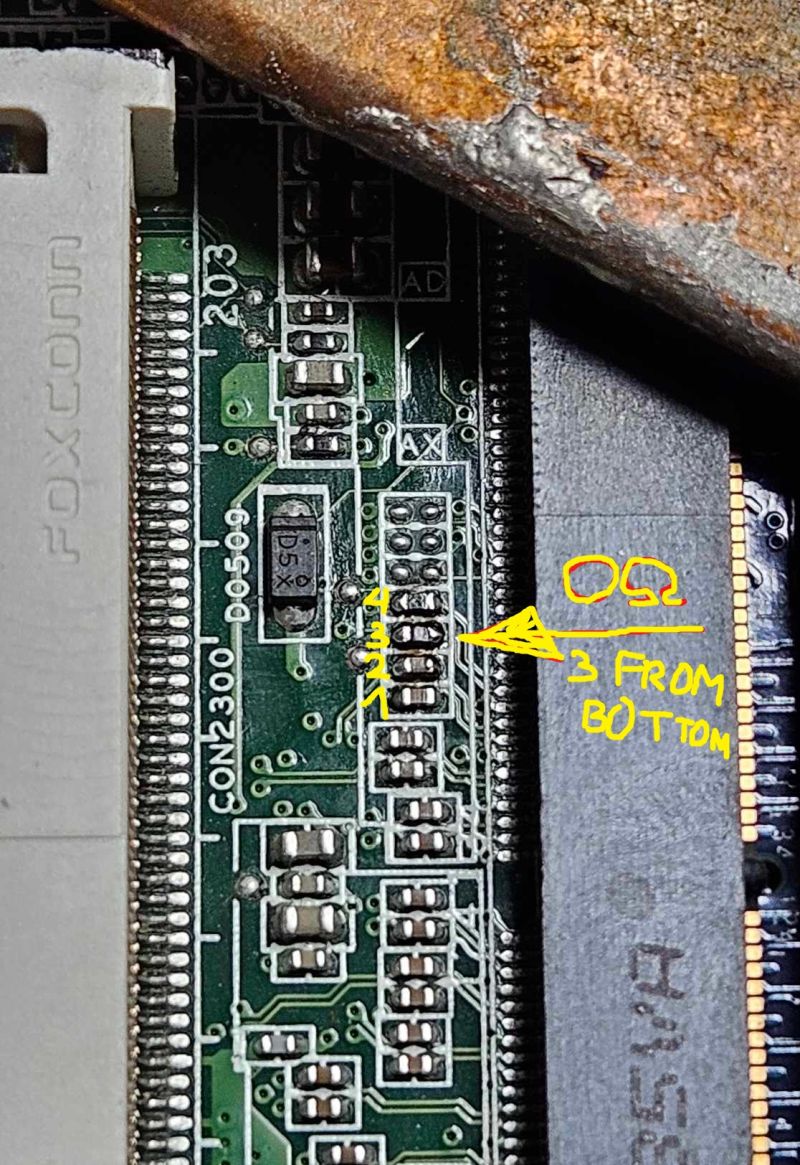

GuitarG Posted July 4, 2025 Author Posted July 4, 2025 On 7/2/2025 at 8:04 PM, SuperMG3 said: Hello. Did you test if RTX 3000 from HP works too? If it works, it means all RTX 3000/4000/5000 work at the end. I can get the cards work on the first slot of my laptop and have better driver supports for RTX 7000 GPUs on the second slot on 3rd gen hahaha Quadro T1000/T2000 or any RTX 3000-5000 will work. Tried few vBIOS on mine, all worked with differences being what ports it outputs, for ex. some vBIOS didn't worked with my Displayport. They also different with TDP, Mhz min and max parameters. I would love to borrow Ampere gen card and check if it would work. 1

GuitarG Posted July 5, 2025 Author Posted July 5, 2025 24 minutes ago, triturbo said: Has it been confirmed? I can’t find any info about it. I’ve seen 980s work with LVDS screens, but nothing about 965. And I mean straight GPU -> screen, no Optimus or something. It is same die as 980, Maxwell gen. So it should work with LVDS display. With Maxwell I had no problem with LVDS screen. I used 980 and checked M3000M. I had a lot problem to make them work with Dreamcolor, though. I used specific driver version, which still supported 10 bit output. 1

Myro Posted July 9, 2025 Posted July 9, 2025 On 7/2/2025 at 7:47 PM, GuitarG said: I have to look for spare 8570W to test my modded cable. Cheapest in my region is about 200$ sadly. So Im waiting for cheapest possible =] If it will work and don't burn anything, I will show connections schematic here! Or maybe someone has one in working condition for sale (or science!) ? In UA the cheapest 8570w now is 80$ with i7-3720QM + delivery to EU 10-20$. Or alternatively I can borrow you mine, but only for the next month
