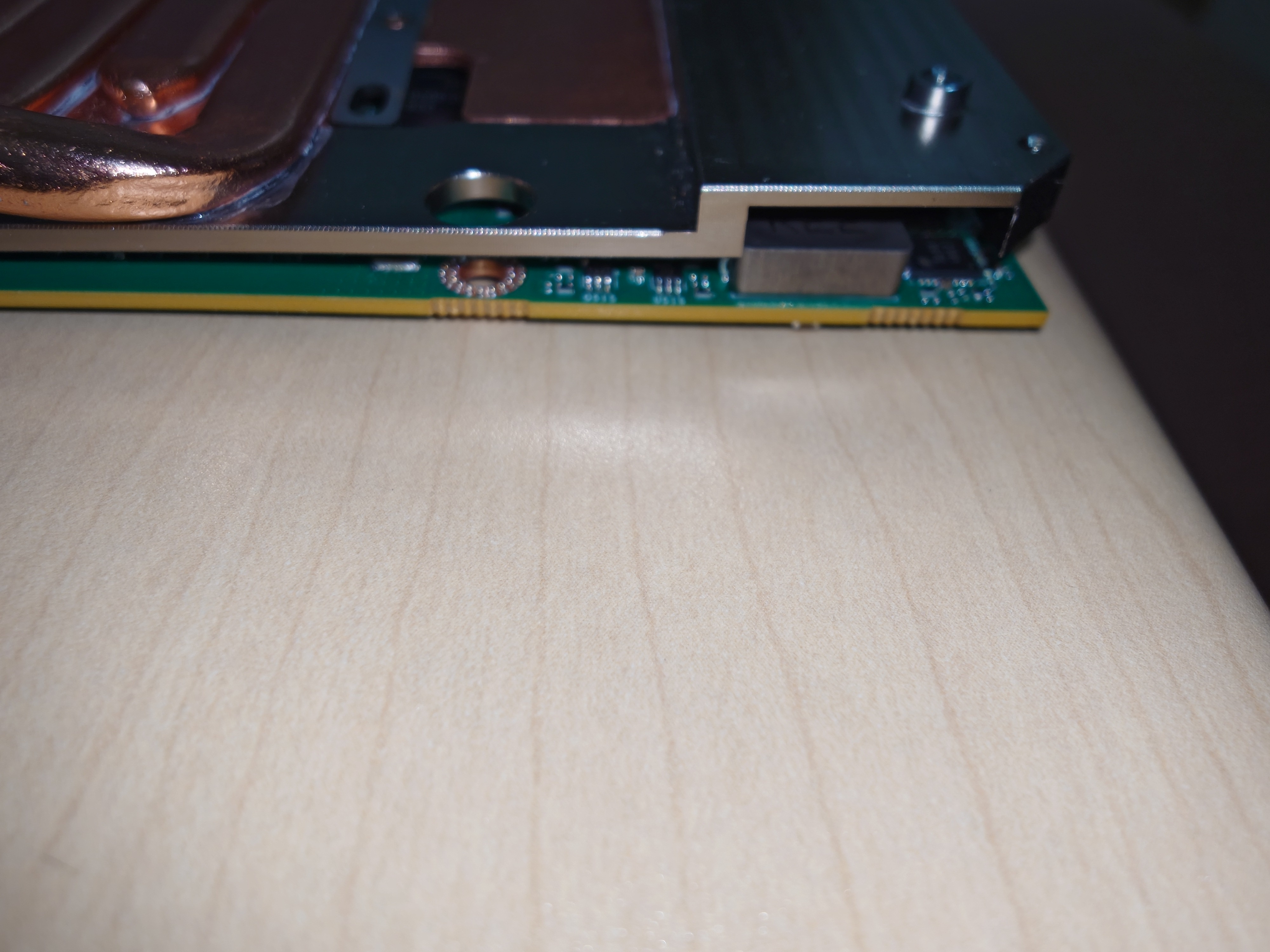

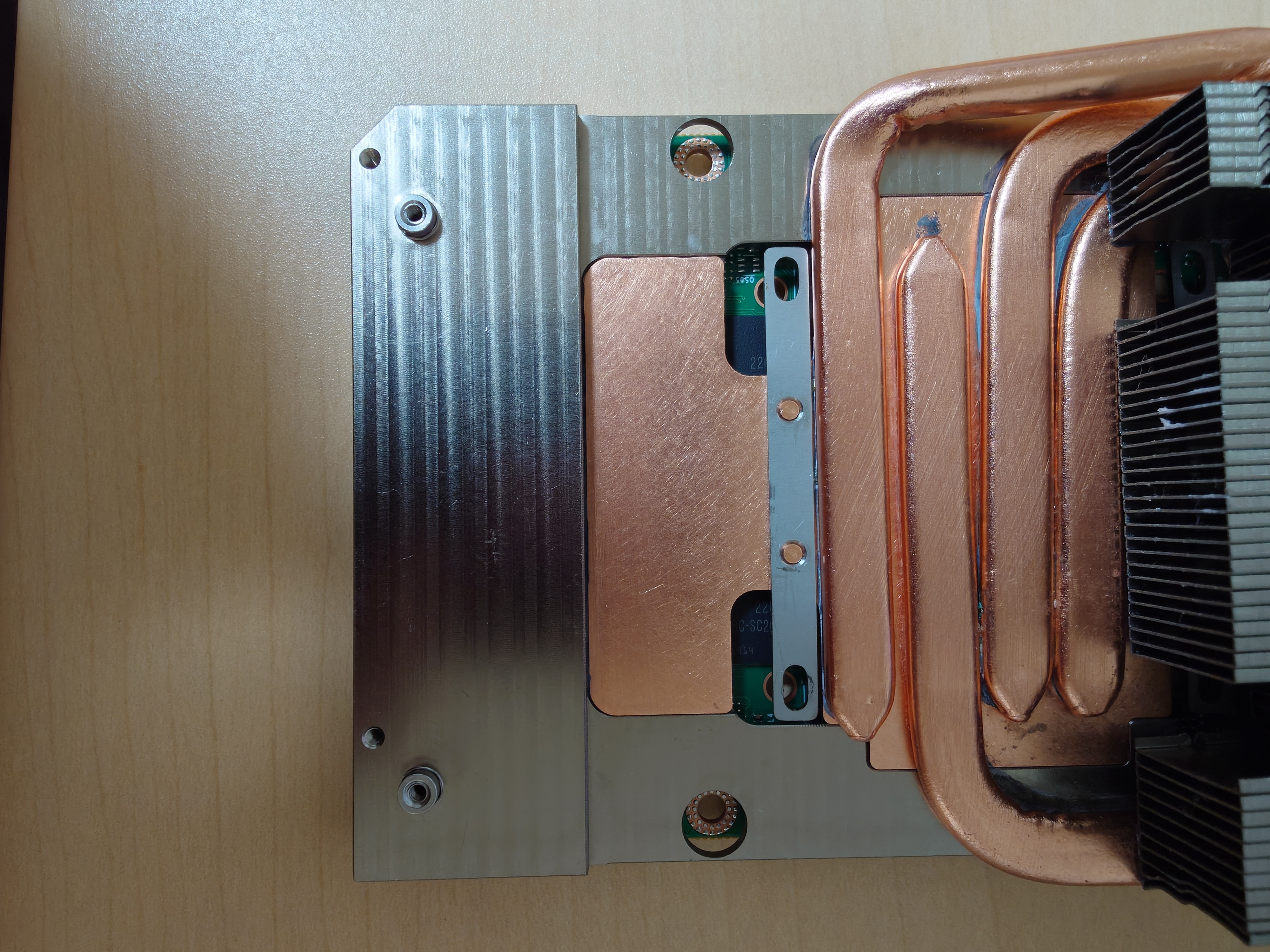

Tetsu Posted September 26 Posted September 26 Hello. I brought the modified heatsink, FPC cable, and X-bracket from the mainland warehouse. When I try to fit them together, the holes on the heatsink and the X-bracket do not align. Also, I haven't applied a thermal pad to this heatsink. Would applying one resolve the issue?
SuperMG Posted September 26 Author Posted September 26 8 hours ago, Tetsu said: Hello. I brought the modified heatsink, FPC cable, and X-bracket from the mainland warehouse. When I try to fit them together, the holes on the heatsink and the X-bracket do not align. Also, I haven't applied a thermal pad to this heatsink. Would applying one resolve the issue? Mine v1 fits, try again. I have it on my P570WM3 installed right now. You need to use 1.5mm thermal pads for the VRAM. I was selling v2 but they all sold out.

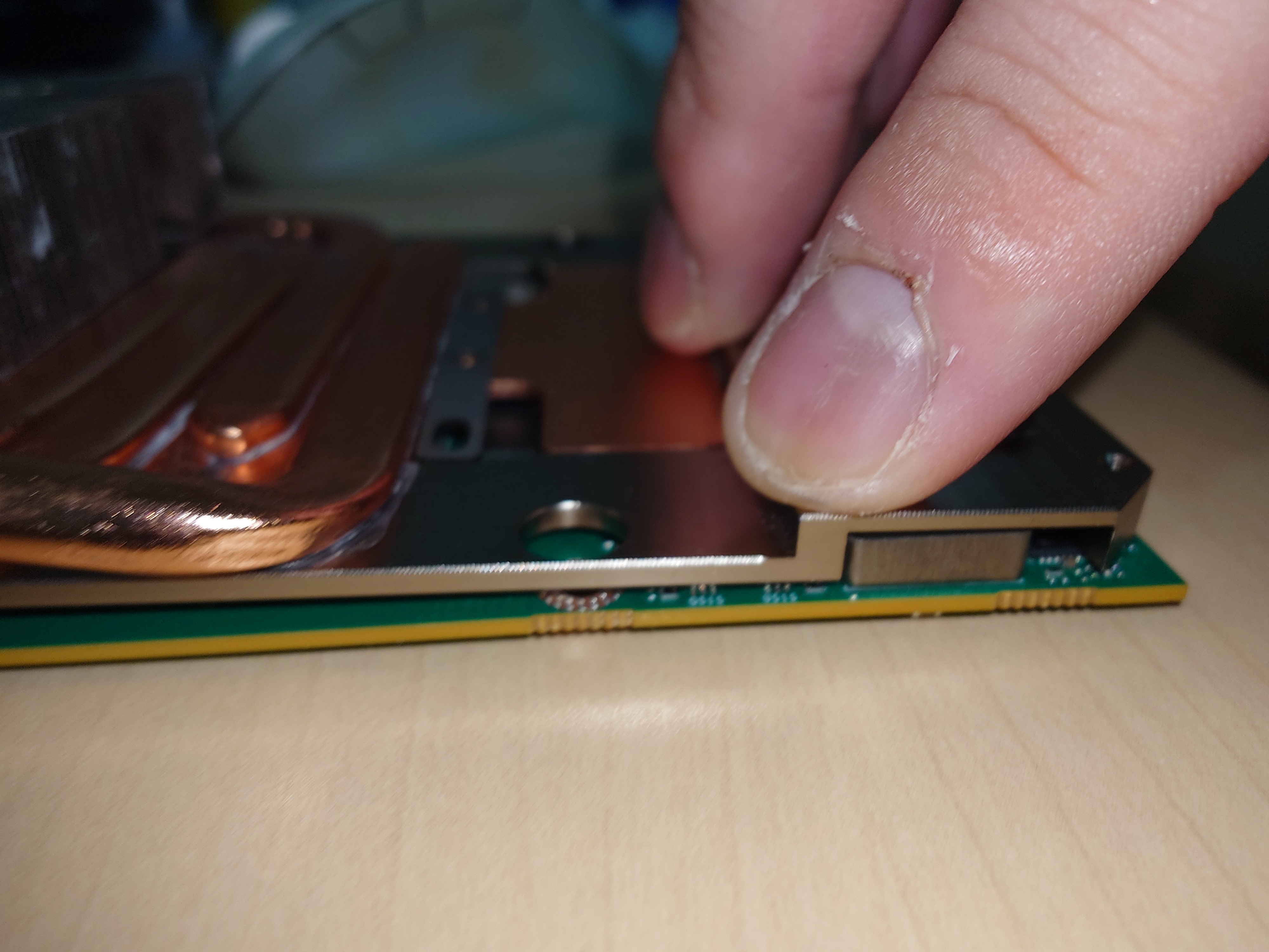

Tetsu Posted September 26 Posted September 26 This card and the heatsink aren't a match. If you try to fit them together, part of the heatsink gets in the way. You'll have to shave off a section of the heatsink.
Tetsu Posted September 26 Posted September 26 I haven't tested these while installed in the P570WM. Mounting them in the unit might solve the issue, though...
SuperMG Posted September 26 Author Posted September 26 11 minutes ago, Tetsu said: I haven't tested these while installed in the P570WM. Mounting them in the unit might solve the issue, though... You use them without thermal pads... With thermal pads, it fits. You also need to modify your fan mounting as the factory for the v1 didn't respect my needs. V2 fixed the mounting but I sold them out. I sold 4 v1 and got 0 complains tho.
Tetsu Posted September 26 Posted September 26 Given that there are no complaints from others, I simply ended up with a defective unit. The factory likely didn't test-fit the part against the actual card—instead manufacturing it based on SuperMG's blueprints—and I just happened to receive a unit with a slight misalignment. Since there are no companies in Japan that will modify metal parts owned by private individuals, I plan to file it down myself. It’s only off by about a millimeter, so I think I can manage it. I do regret not buying the Heatsink V2.

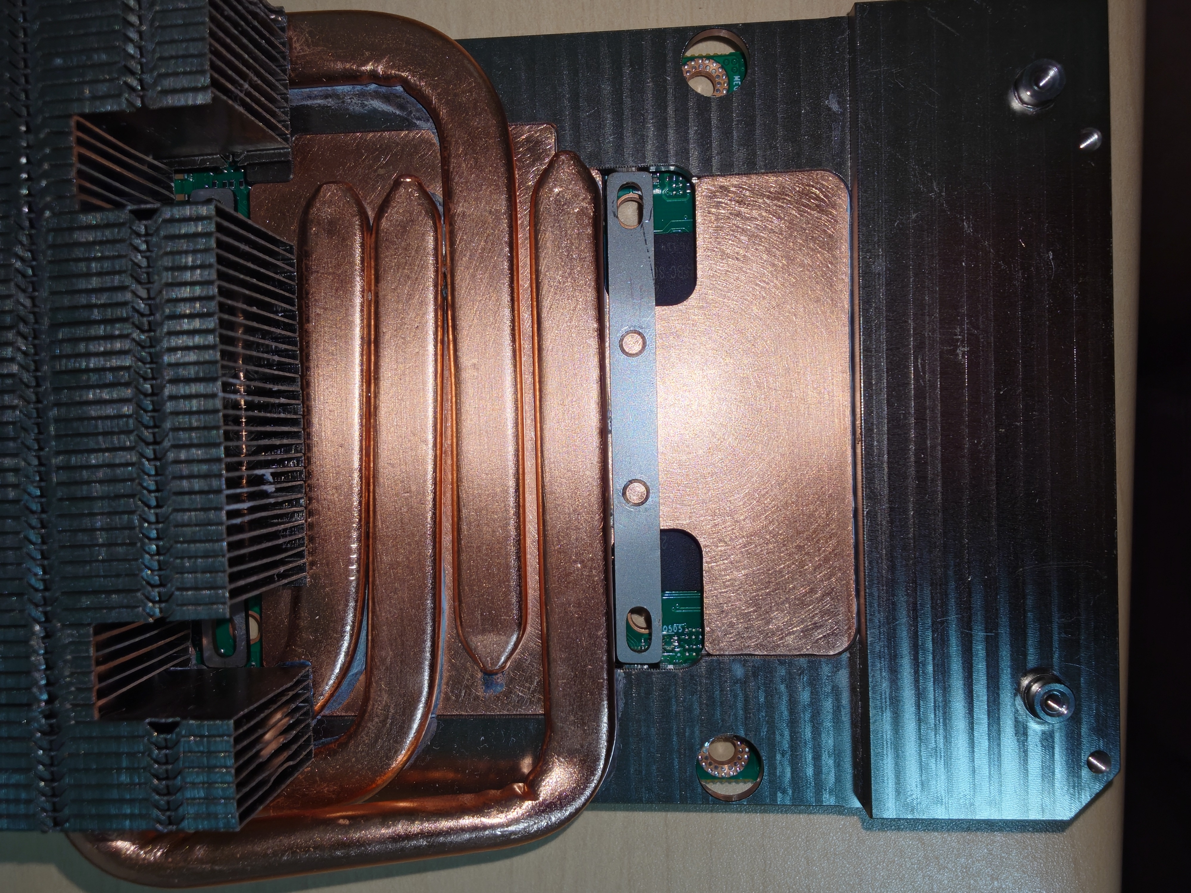

SuperMG Posted September 26 Author Posted September 26 17 minutes ago, Tetsu said: Given that there are no complaints from others, I simply ended up with a defective unit. The factory likely didn't test-fit the part against the actual card—instead manufacturing it based on SuperMG's blueprints—and I just happened to receive a unit with a slight misalignment. Since there are no companies in Japan that will modify metal parts owned by private individuals, I plan to file it down myself. It’s only off by about a millimeter, so I think I can manage it. I do regret not buying the Heatsink V2. Look at my Google drive picture, it's the V1 and I have good thermals. Next step is to modify the fan blades on the weak 5V fan. https://drive.google.com/file/d/1t6qw10VFocoxQ2xFBCUk4W9FMblCOLLh/view?usp=drivesdk
Tetsu Posted September 26 Posted September 26 14 minutes ago, SuperMG said: 私のGoogleドライブの画像を見てください。これはV1で、放熱性能は良好です。 次のステップは、出力の弱い5Vファンの羽根を改造することです。 https://drive.google.com/file/d/1t6qw10VFocoxQ2xFBCUk4W9FMblCOLLh/view?usp=drivesdk That looks like a good fit. It's 9:30 PM Japan time and getting late, so I'll try installing it in the P570WM tomorrow. Thank you for providing the photos.
SuperMG Posted September 27 Author Posted September 27 20 hours ago, Tetsu said: That looks like a good fit. It's 9:30 PM Japan time and getting late, so I'll try installing it in the P570WM tomorrow. Thank you for providing the photos. I'll soon manufacture 2 P570WM3 GPU fans with lots of blades. Want one? It'll cost maybe around 30-40€ for a custom one.
